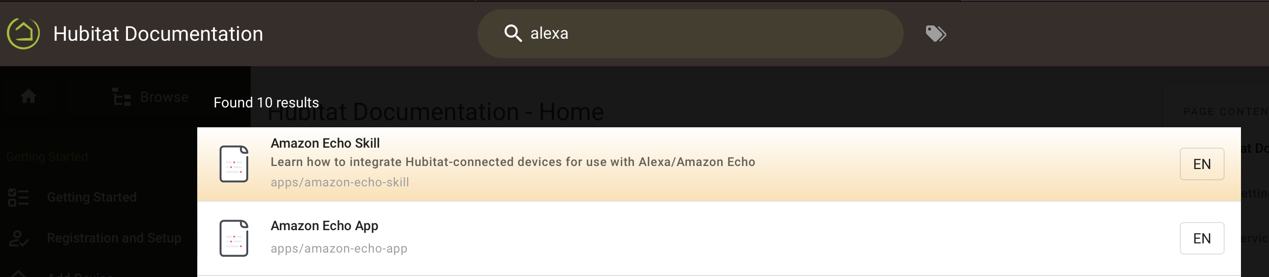

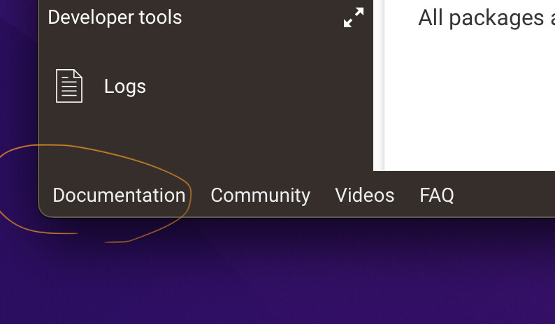

Welcome to Hubitat. I migrated over from SmartThings about 3 years and I have to admit it took me a while to notice the "Documentation" link right there at the bottom of every HE page.

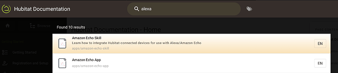

I tried clicking on that and then searching for "Alexa" and got this link which walks you through the entire process of integration with Amazon Echo.
Great article in the first link. For anything that's built-in the docs are actually quite good. And you did well to post here in https://community.hubitat.com/ where thousands of true enthusiasts are happy to help. But, sometimes you want immediate answers, and most of them can be found in either Documentation or Community. Cheers!
