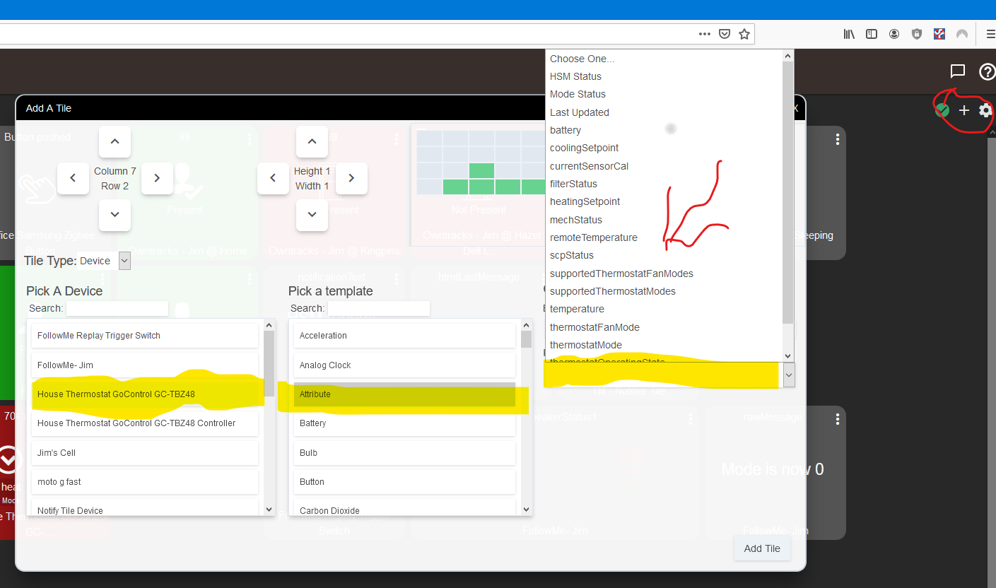

There is a battery template that will display the attribute from the First Alert driver.
It's not elegant - but if you click the + on the dashboard and add a tile - you can add a second tile for a device, like your FA Detector. then select the device, choose Attribute - then you can pick out exactly what you want in the tile in the dropdown:
