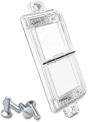

I generally also prefer dimmable smart switches instead of messing with bulbs. People do indeed tend to turn off the power to fixtures with smart bulbs in them. Sometimes you have no choice, though. To that end I have found a couple of handy things:
and
