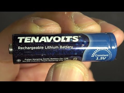

I came across some Tenavolt rechargeable AA batteries. The batteries actually contain a 13430 3.7v 750mAh 2.78Wh Li-Ion battery and a built-in bms to maintain a constant current of 1.5v. Just thought I'd bring this up for people with locks and such since they behave better at 1.5v rather than 1.2v that NiMH rechargable batteries put out such as the Enloop batteries that are so popular.

Here's a good video of a teardown for the battery.

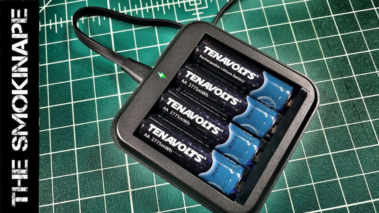

Here's a good review of the relevant information about the Tenavolt batteries.
Just what I was looking for, Thanks for the info perfect timing too! I wonder if My opus BT-c3100 would be okay charging them?? Charger shouldn't make a difference?
Yea, I bought 20 of them along with the wall charger. The charger build quality surprised me. It's powder coated and has some heft to it, I was expecting a crappy plastic one.
Charger does make a difference. The bms only plays nice with their charger.
