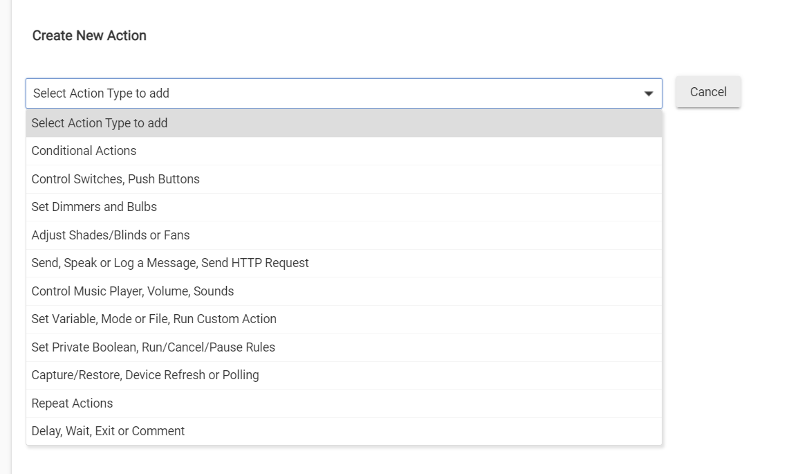

The action for activating a scene is missing from Rule Machine 5.1 and Button Controller. This screenshot shows that the "Activate scene" action is missing from the drop down list:

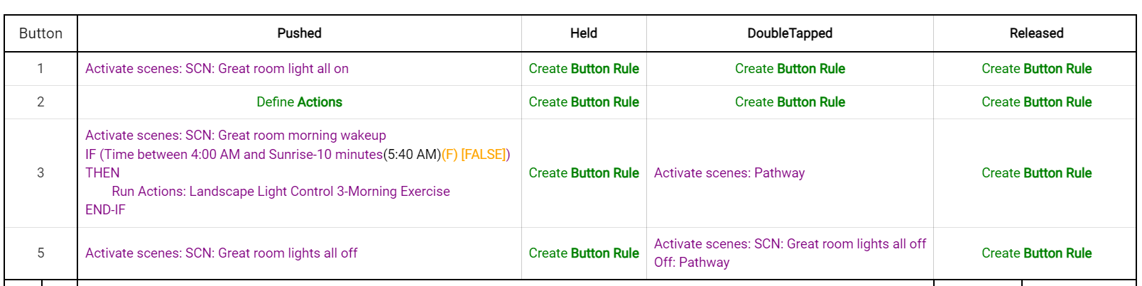

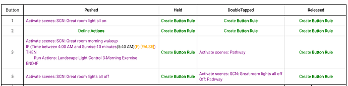

As you can see from this screenshot, I have several rules that I have created in the past that can activate scenes:

It's actually there; you just need to look under Adjust Shades/Blinds or Fans to find the Activate Scenes action. (Some history: the name of this "category" used to mention scenes until Room Lighting was introduced and Groups and Scenes was deprecated and this action removed for new rules, along with renaming the category to reflect that; both decisions were eventually un-done, but the name of the category remained even though the action was added back. Room Lighting would still be the preference, and perhaps the desire to de-emphasize Scenes in favor of this is why.)
Room Lighting can be used to create the same outcome as scenes or groups, but I assume that is not what you mean here, so the above answer is not likely to be applicable to your situation.
@bertabcd1234 thank you very much for the quick reply. That explains quite a bit.
I'll look into Room Automations when I get some spare time. In the meantime, I found "Activate Scenes" right where you said it would be.
