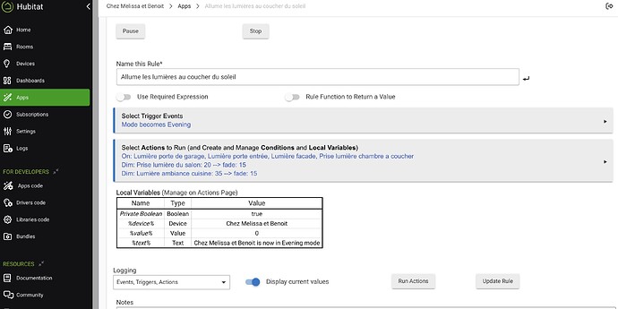

Here's my rule:
Actually your rule does not turn on any lights at sunset. As it is written, it should turn on the lights when the mode changes to evening. When that happens could be anytime. :rofl:
To test the rule itself, manually change the mode to evening, and see if the lights turn on, which I expect they will.
After confirming your rule is working, then investigate if the mode is really changing to evening at sunset. What rule or app are you using to achieve this mode change?
I don’t see an obvious problem with your rule. From the copy/paste of your log data, it does look like the Mode does change, and then the rule is triggered. So it is odd that the lights don’t react properly.
One thing you could try is to remove that specific rule and then recreate it. Make sure you enable all logging in the rule and then keep an eye on things to see if they work or not. If not, please screen capture the pertinent log data and paste it here, along with the new rule, to allow the community to help debug the issue.
