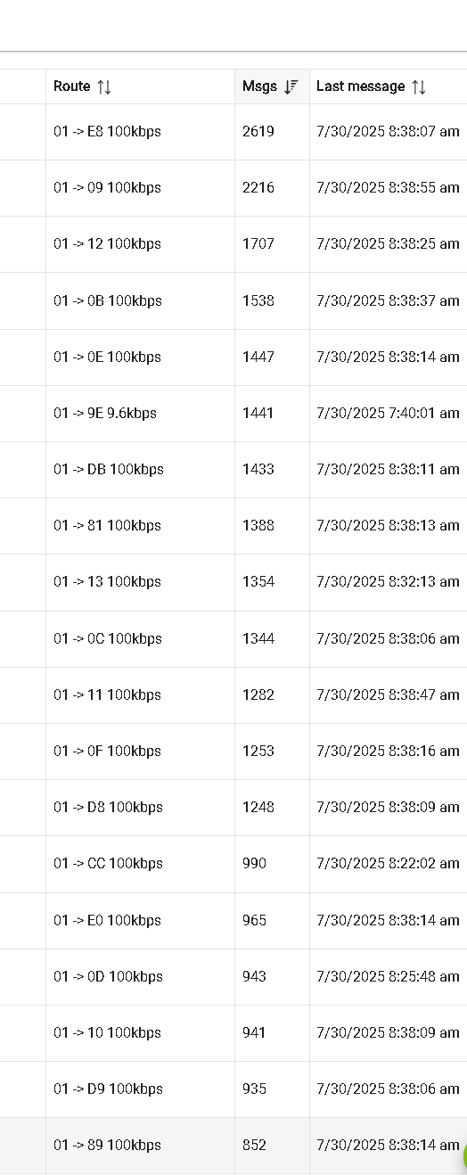

Hi All,
In the aim of optimizing my zwave bandwidth usage (of which i have 66 zwave devices) i would like to gain an idea of what the community deems as acceptable range (low and high numbers) of number of messages received per hour from a single zwave device. I realize this is relevant to how many zwave device you have join and "chatting" so we should assume when defining the range that the zwave hub has a higher population of zwave devices e.g over 50 zwave devices. I am also referring to the use of non LR devices and the original zip zwave stack. Looking forward to your recommendations and thoughts

I have close to 100 Zwave devices and I have never looked at that column until your post. When I sorted it based on msgs and looked at the devices with the most messages I observed that a Zwave motion had the most which makes sense, it’s outside and lots of moving objects. The next highest was a switch where I have a room lighting rule turn it off frequently because it’s in a high traffic area.
Personally this data point isn’t relevant to me because my mesh is working well. Years ago, been on HE hub for 7 years, I had a device go bad and things weren’t working well. Major slow downs and missed commands were observed. A zniffer helped figure out which device was spamming the mesh. Once removed all was well.
Of my 66 zwave devices 30 of them can report on 6 different sensors each and the light switch's can also report on power which can overwhelm zwave bandwidth. The numbers i have shown in the screenshot are greatly reduce to what the were with default reporting settings and i am attempting to establish a safe hourly message rang from the community that may have a higher number of chatty or reporting zwave devices
