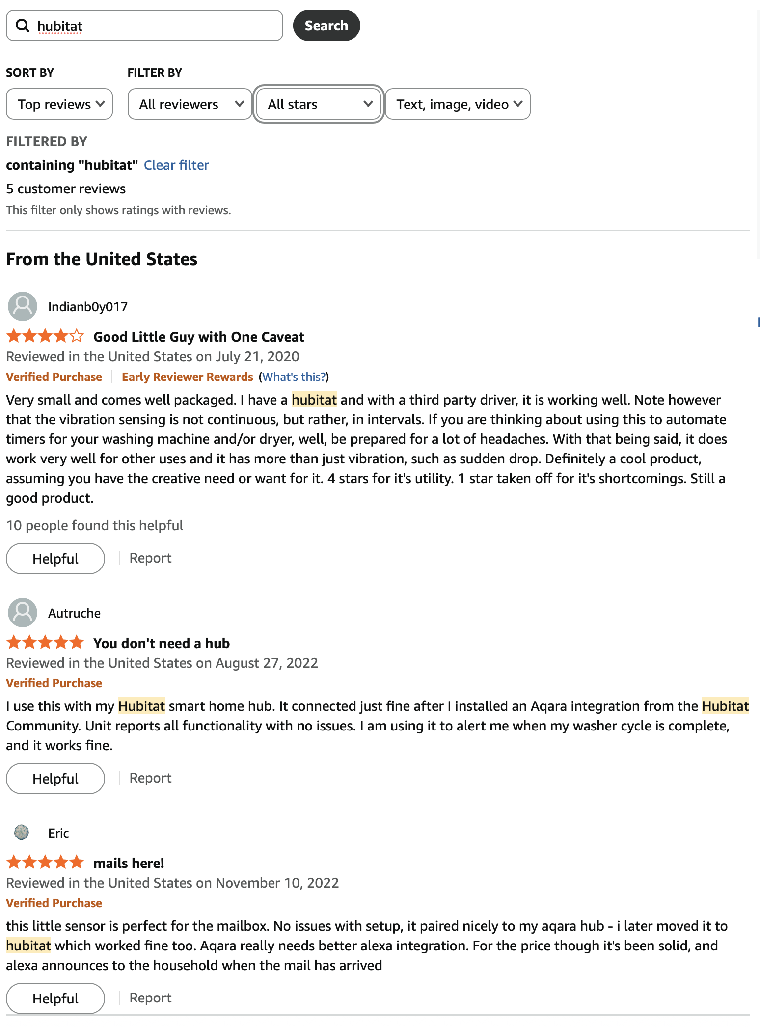

If these are Zigbee, why does the listing state, " Requires Aqara Hub (not 3rd-Party)?"
The short answer is - the same reason Tuya zigbee devices often indicate they only work with the Tuya hub, or Iris devices were advertised to work with the Iris hub.
The long answer is that before zigbee 3.0 became the norm vis-a-vis coordinators, Aqara devices did not stay connected to many coordinators. Especially if they only supported ZHA 1.2.
There are a sufficient number of community drivers for older Aqara devices like the one you linked to, and as indicated by Amazon reviews, the device works well with Hubitat.
If I were you, I would get the T1 version of that sensor, because it is a zigbee 3.0 device.
