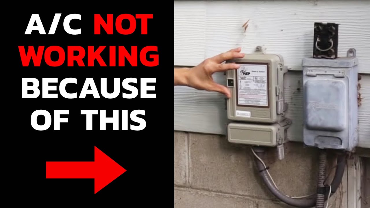

The ones I've seen are directly at the outside unit. They're called "Power Saver Switches", which they control by some radio control to cut power at specific times to A/C condensers. Here's an example:
