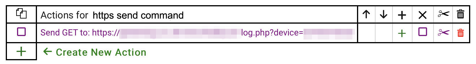

i dont think anything extra is needed, just the rule with the URL as a https:// address (as opposed to just http://....)
This kind of rule (in rule machine) works fine for me:
not sure if that is the answer you were seeking?
be interested to know more about what it is you wish to achieve and how you go about it
