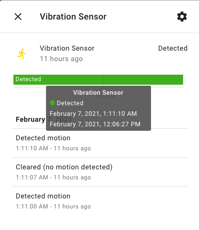

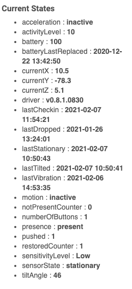

Wow what a massive disappointment the Xiaomi Aqara vibration sensor driver is in HA. Shows time of vibration event only and their overall battery reporting is crap. Compare that to what @markus created for HE. Pretty clear to me I'll never personally use these sensors anywhere but directly joined to HE, otherwise you lose all the really cool benefits of owning them.
Xiaomi sensors are way more capable than even Xiaomi themselves take advantage of. They only show tilt and vibration events on their gateways. I was really surprised to learn from @aaiyar that there's even temperature on the Aqara contact sensor, but it's only currently possible to see it via zigbee2mqtt.

Zigbee2mqtt exposes everything that is in @veeceeoh/@markus' driver.

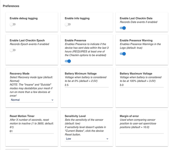

@chirpy has developed (and continues to develop) a universal Hubitat driver for Aqara sensors/button. I told them about the temperature sensor in the Aqara contact sensor, so perhaps we'll see that soon in a Hubitat driver.

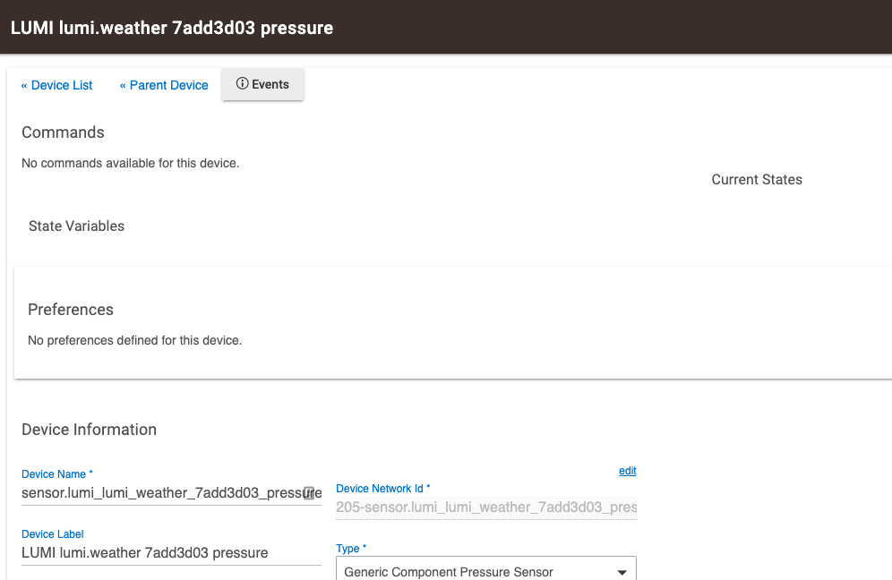

Just joined Xiaomi Temp/Humidity/Pressure sensor directly to HA. I have temp and humidity components in HE, but no pressure yet. I still have the parent and child devices from last night loaded. I'll keep an eye out for pressure to be reported. I don't know it's frequency, but I would have thought it would be there on initial pairing.

No pressure Generic Component at all now. Getting Temp and Humidity and they're reporting OK.
@tomw there is no event handling or parse method in your community component drivers. That's why the state values are not being added/updated.
@SmartHomePrimer, I loaded the parent and component drivers in the repo linked and they were created for me..but as stated above they are not reporting values.
