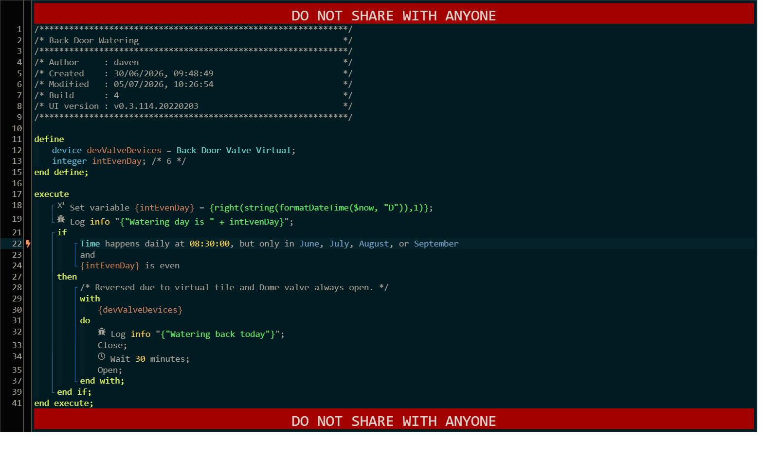

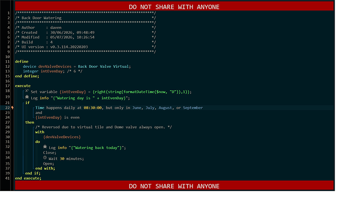

This is all I could come up with to water my lawn every 2nd day.
Seems to ignore PST and is only UTC as the answer is 6 even thought it’s the 5th ATM.
Anything more elegant?

Turn out my piston doesn’t work anyway due to 31 and 1 end of month. :frowning:
The Julian date ends up out of sync so I need to use a format that is just the last integer of today’s date.

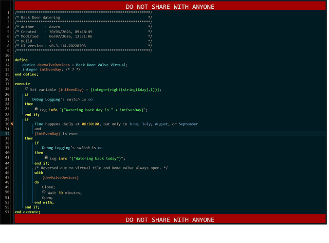

I don’t know why I missed the var $day, integer(right(string($day),1))

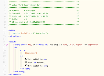

Maybe something like this (not tested)….

You can add month restrictions to the every day schedule:
That’s why I thought what I was doing is inefficient.
I was twisting my brain and couldn't remember the Mod operator.
Thanks!
