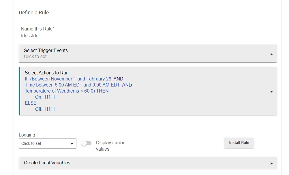

I want to create a rule that will turn on a switch (in this case one that is connected to a floor heater) daily during the months of November, December, January, and February from 6 am to 9am but only if the outdoor temperature is less than, say, 60 degrees.
I don't currently see a way to do this in Rule Machine, but could it be that I'm wrong?
Can't you just use the time and temperature? I assume the temp would generally only get down that low in those months anyway?
What particular part do you feeel there is no option for?

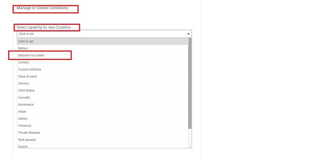

There is a between two dates option for a conditional, that would handle the from Nov to Feb par. That along with a certain time conditional and some type of temp sensor or weather app that reports temp it should be a pretty simple rule.

The only thing I think will take a bit of thought is how to trigger this. Temperature? Time of day? Otherwise, this is just a quick idea of what you probably are thinking of.
Maybe trigger every day at 6:00am,
Then if not between Nov and Feb exit rule
Then wait for event temp < 60 or time is 9:00am
The rest of the rule can stay as is, but you can remove the between dates as it that would be taken care of by the exit rule. I would also add the last END IF
I don't think I would trigger on temp as it would be triggering all the time.

How do you get the "between Nov and Feb" part? Is that under "capability?"

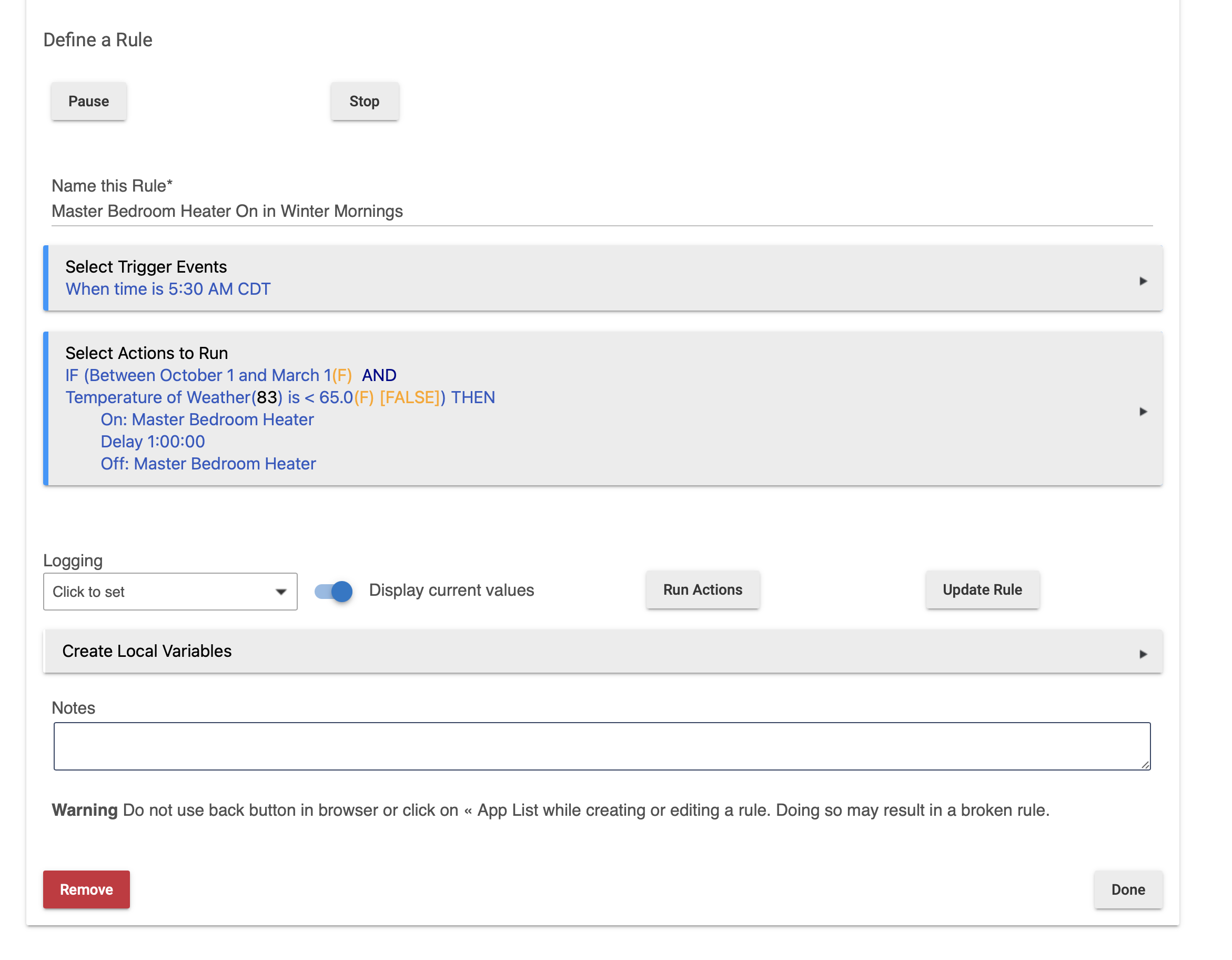

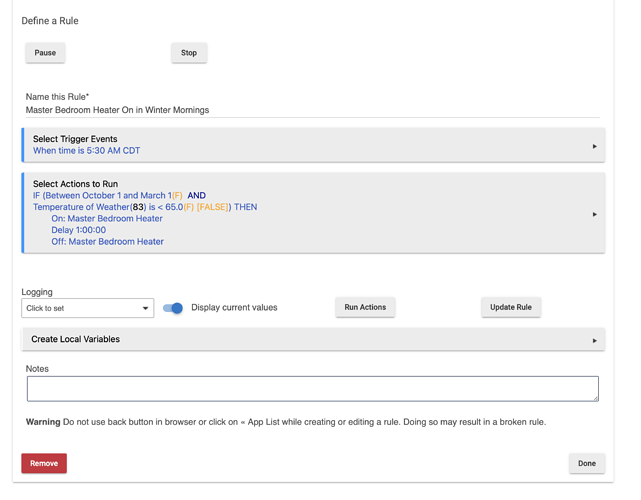

OK, got it. I think I got something working here. I don't use Rule Machine a lot, so please give me feedback on this.
This will fire at 5:30am every day (about 30 minutes before I get up, to warm up my bedroom in preparation for waking up at 6am). At 5:30 am every day, it will check if the date is between October 1st and March 1st AND if the outside temperature reported by my weather App is < 65 degree, THEN (if both conditions are true) it will turn on the master bedroom heater at 5:30am, and then turn it off at 6:30am.
Does this look right?
The only thing I see wrong with that is it only will trigger (run) one time, at exactly 5:30 AM. You may want to or need to add additional triggers. Oh, and maybe a virtual button or switch on the dashboard to trigger things manually.
Lastly, what if you want to turn it off early? Do you want some logic for that too?
As @neonturbo mentioned this rule will fire at 5:30am and turn the heater on for 1 hour, if it's below 65 and between the dates you set.
If that is what you want then it should work.
Also I would add the final ENDIF, shouldn't really cause an issue as RM doesn't seem to care but I am mildly OCD and it bugs the crap out of me. :slight_smile:

Every IF should have an END IF. In your code it is not required as you don't have any additional code at the end of your IF, and RM is not strict on that.
I have been programming in a language for over 30 years now that is used for automatic test equipment and the program won't compile if your IF doesn't have an ENDIF. So it just makes me twitchy when I see it.
Also, while not true for this particular rule, the failure to properly close an IF block can result in nested IFs with undesired effects on rule execution.
