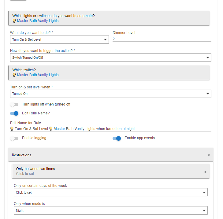

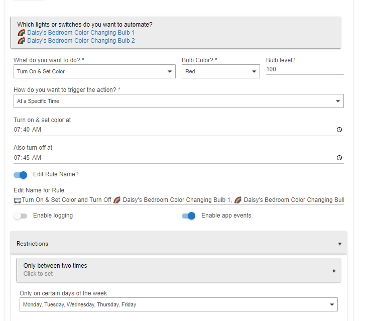

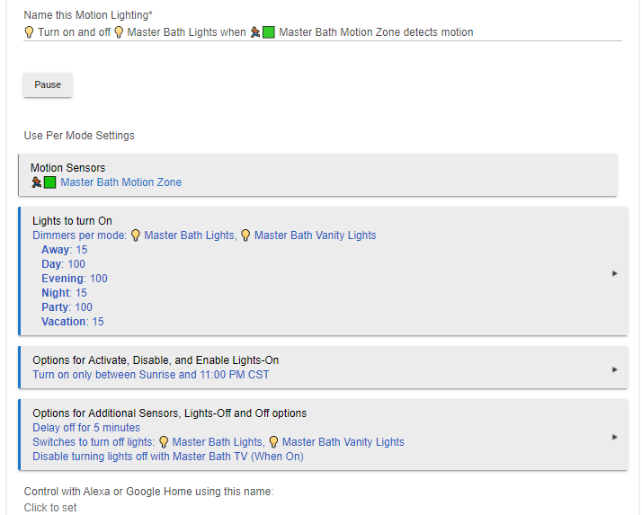

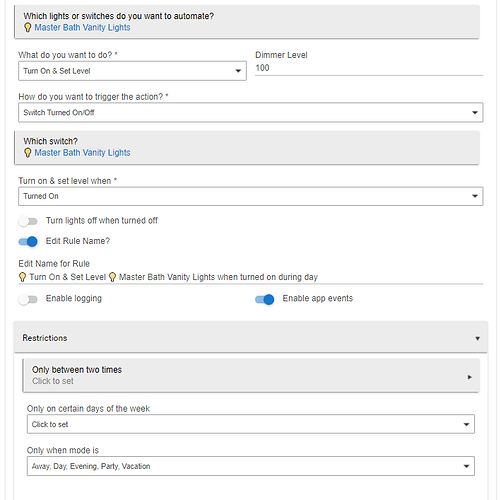

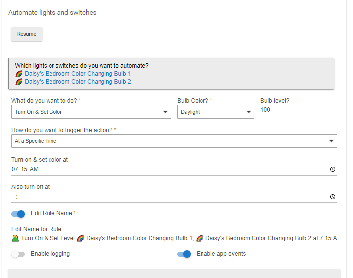

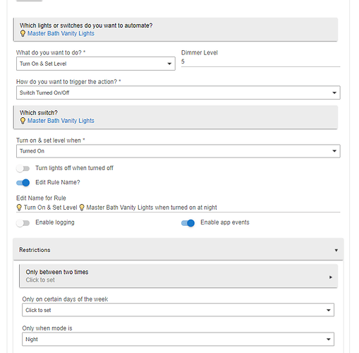

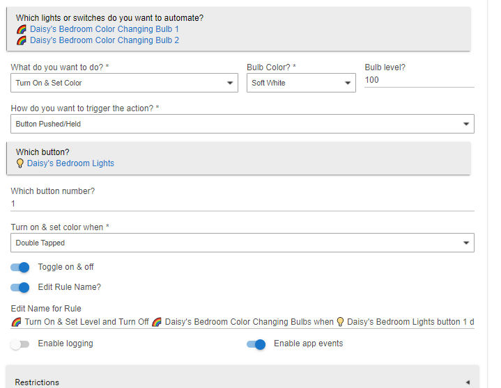

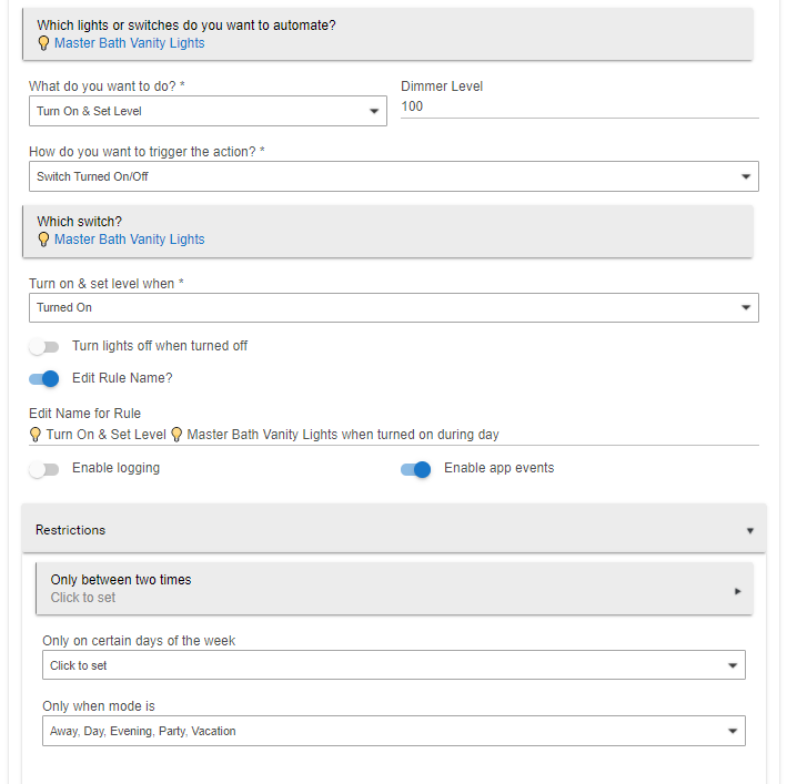

All of these are conditionals. I personally wouldn't use the conditional in these and just say at this event do this. I have designated areas that I want to do certain things with certain events. Like when I come home turn on the entryway lights and hallway lights. If I wanted to expand on that and have those lights do something for different modes I would create a second rule with whatever trigger and its settings specified and restrict it to that mode. My bathroom is another example during the day turn on the lights full brightness when motion detected. At night turn on to 5% brightness when motion detected. Here's some other examples also...
Okay, I am starting to see the method to your madness... though I wonder at the end of the day, is it really better to have 8 'simple' rules, when you could have a single RM? I wonder where the break-even point is in terms of effort, overhead, reliability, etc. That's the beauty, but also the greatest shortcoming of a platform like this. So many ways to skin the cat.
I'm leaning towards "Yes". :slight_smile:
Performance is going to benefit from fewest lines of code. The more processing power it takes to navigate a large rule the less power is available for another Event. Second Event has to wait for the first. We're discussing fractions of a second, on a device that does a billion things per second, all day, all night. So it's going to become apparent ONLY when a number of Events get backed up behind a longer running automation. Events spaced far enough apart just keeps the processor from getting too cold :smiley: and a jam packed Rule is OK.
