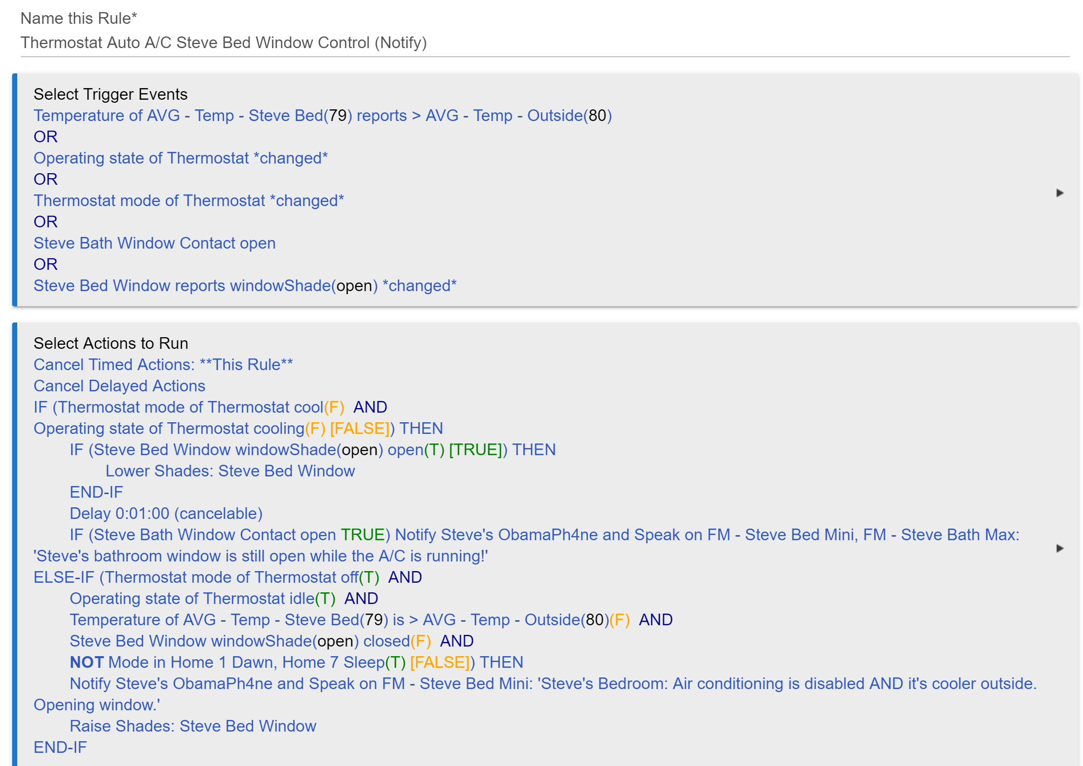

What sort of automations do you have? Chromecast? FollowMe? Alexa? With that many devices, you must have hundreds upon hundreds of RM instances. I've got dozens of scenes/groups, and maybe 115 rules across both hubs. That's with semi-complicated rules, without breaking them all out into single-trigger rules.
I'm trying to remove "wait-until" style logic, because that seems to get really messed up when the hubs get sketchy. Still have many triggers per rule though. Stuff like this:
I don't see how you could get away from having this much code as a bare minimum to handle the task though. Perhaps with a ton of individual rules that enable/pause some master rule, but it seems that would end up creating even more overhead.
