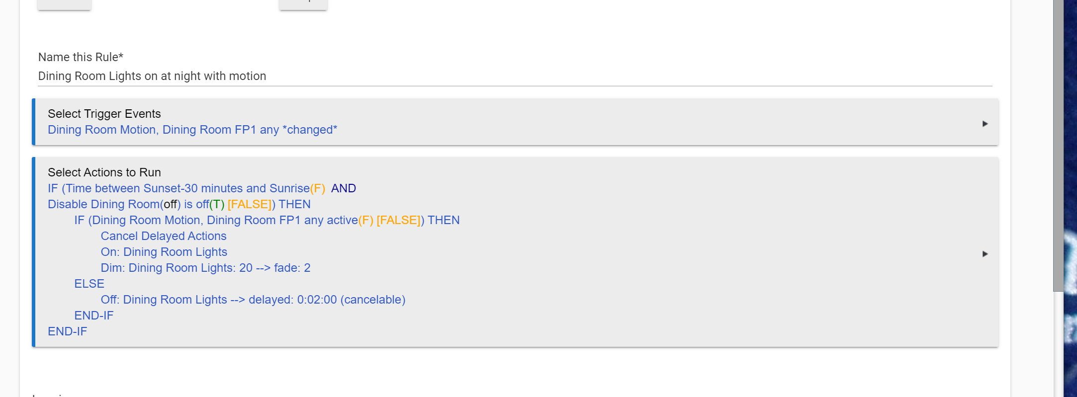

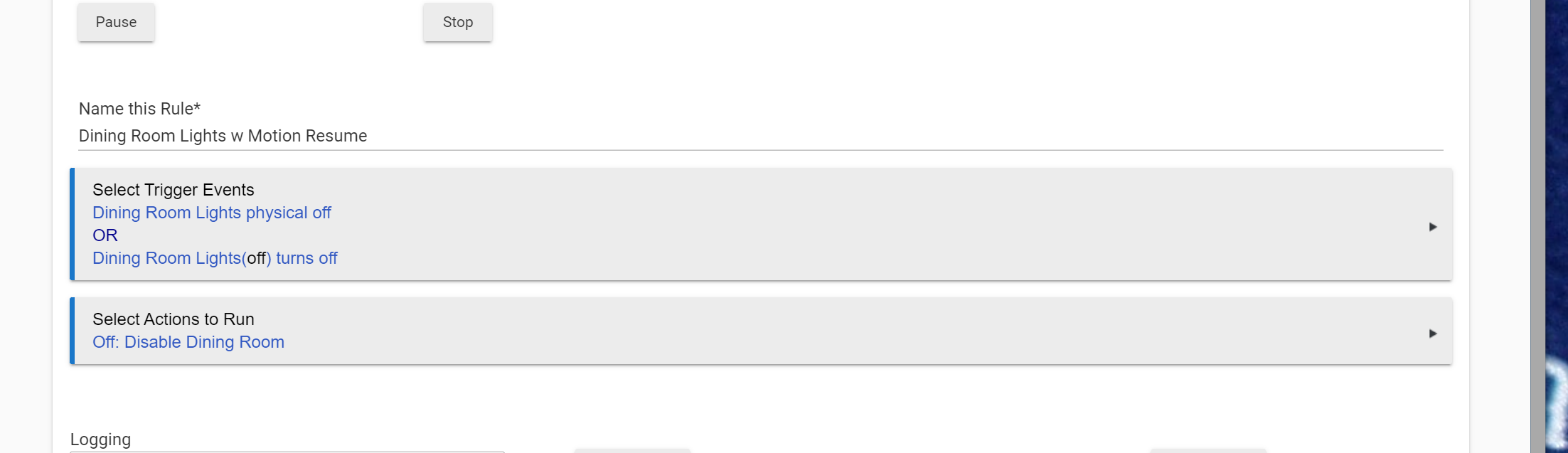

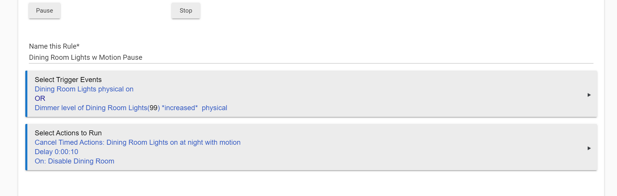

here are my rules.. where i use the physical switch on/off to turn on a virtual swtich and have thet referenced in my rules so it wont turn off the lights in the room after we have manually turned them up with the switch.. you could do something similiar..
i think there are new ways to do this with room lighting.. but my solution does work..
