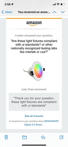

But for me question #1 with mains wired devices is always, can I be reasonably assured they’re designed and built to acceptable standards such that I don’t need to worry about them burning my house down?
Only way I know of is to look for a certification by UL, or similar labs like Intertek and CSA.
There’s no mention of that in the Amazon listing, which almost certainly means it’s not UL certified. However I asked a question on the product page to see what the manufacturer says.

Here’s what they said in response to my question:
So who knows what to think now. I probably asked the wrong question though. It doesn’t matter if they claim to comply with UL standards (which is what I inadvertently asked), it really only matters if they have been certified by UL (or a similar lab). Either they haven’t, or it’s not clear. So for safety’s sake, pass.
I asked whether they were certified, or comply. We will see what they say...
I asked the same question after the vague 1st reply. They confirmed. They are not UL certified.
