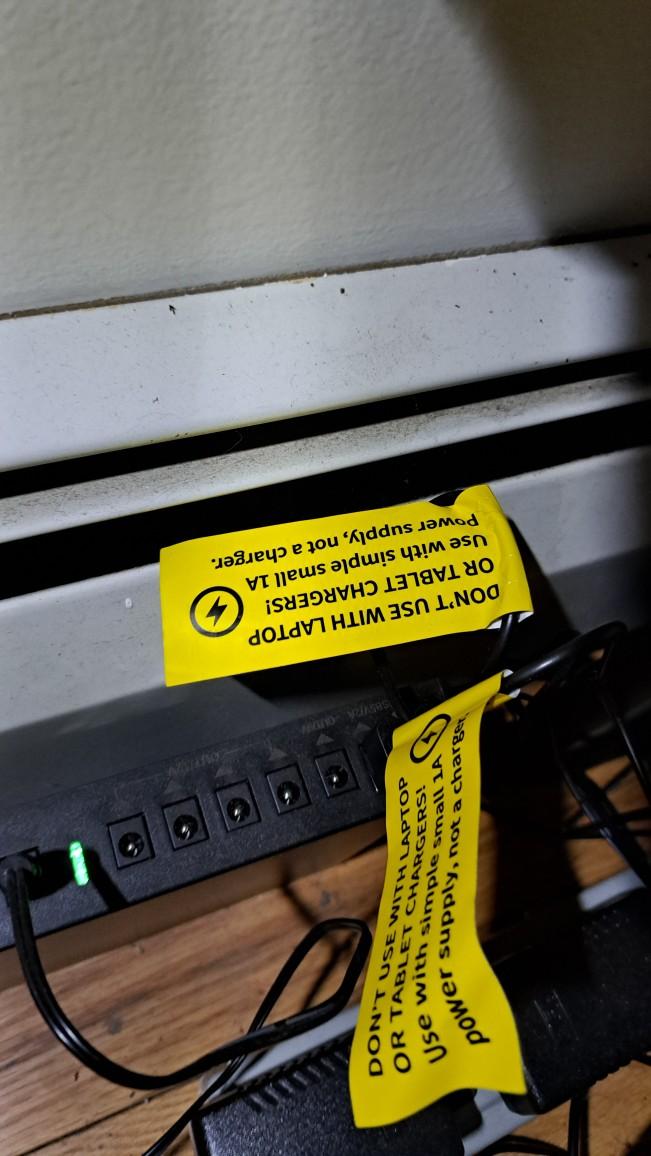

They tell you to use a simple power supply, not something designed for phones...something like that.
I was just looking at a ZEN16, which is being powered by 5 volts, and lo and behold, there's a label:

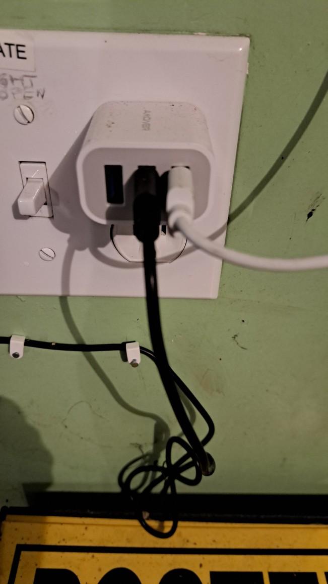

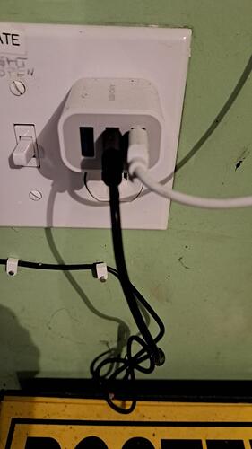

Two ZEN16s here, both being powered via USB-C, no problems.
