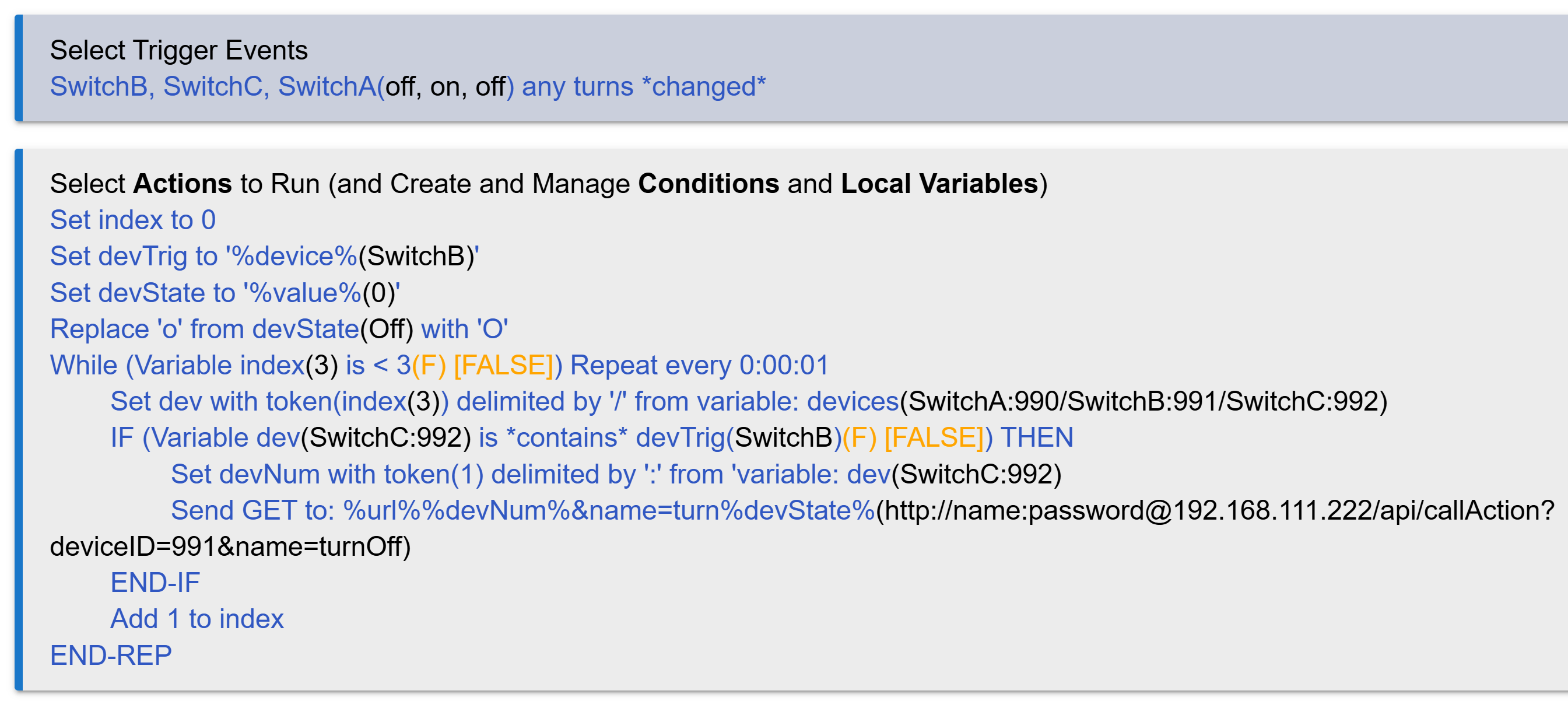

As they used to say on TV, "I can name that tune in only 12 notes!" I mean actions. Leveraging some of RM's peculiarities (while carefully sidestepping others), I was able to create a rule to do what you asked, using a WHILE loop:
Special care was needed to parse the GET url syntax you're using, e.g. capitalizing the 'O' in 'turnOff'. But it works, only sends a single HTTP request per event, and should be easy to maintain. You can even add unlimited devices (as long as you update index to the exact count, since RM will choke on array overruns).

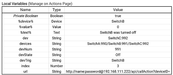

For clarity, here's how I set up the Local Vars in that rule:
