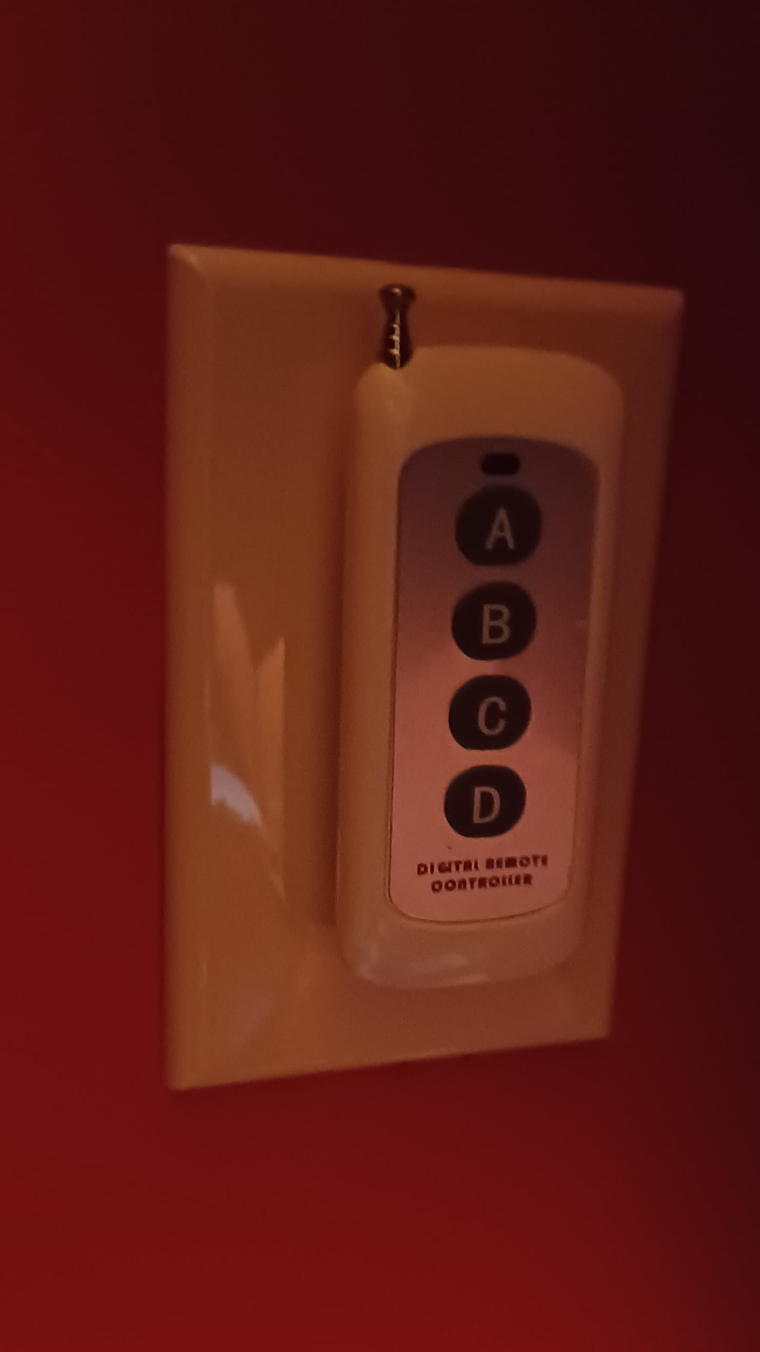

Here is what my application is.
Single gang decora 4 button switch that I can control 4 different devices.
The only way I can figure out how to do this is with a 433Mhz transmitter that activates a 4 relay
zigbee or other wifi device that when the HE sees the toggle will trigger the toggle of another device. In previous home control days (X10) they offered a in wall single gang keypad that was able to control either 4 or 8 devices. Since I DA all my X10 stuff I have been trying to be able to do this. I have done it but its ugly. (4 sonoff 433Mhz/ Tasmota relays) and they are close so it works. The other devices are all over the house. Not sure this explains this the correct way.

I saw those and you can stick those anywhere . What I am looking for will fit in a single switch box (US) or be usable in a multi gang electrical box accommodating a decora format..

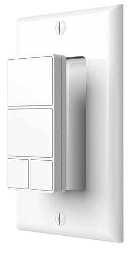

That ZOOZ SCENE CONTROLLER may work for me.
If you interested this is what I had in a variety of locations in the house.
All that stuff lasted 20+ years and if it was still viable I would use it.

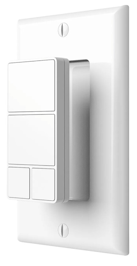

Minsoton and Zooz both make a version of this wall-mountable remote.
The Zooz "scene controller" is also good.
