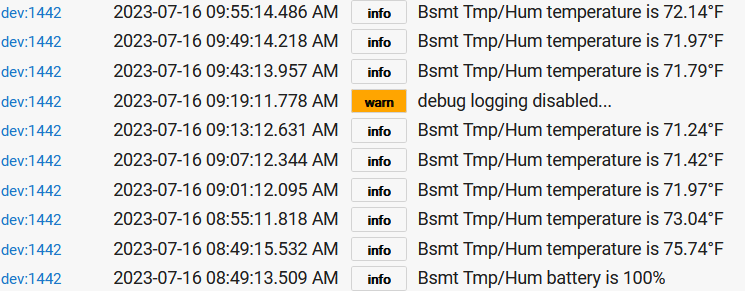

After being synced for the first reading or so, the display is locked again.
Log reads 71.9 and display is locked at 73.9.
Weird.

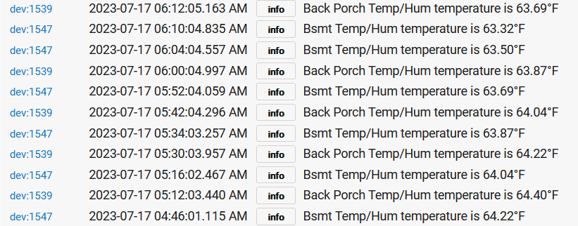

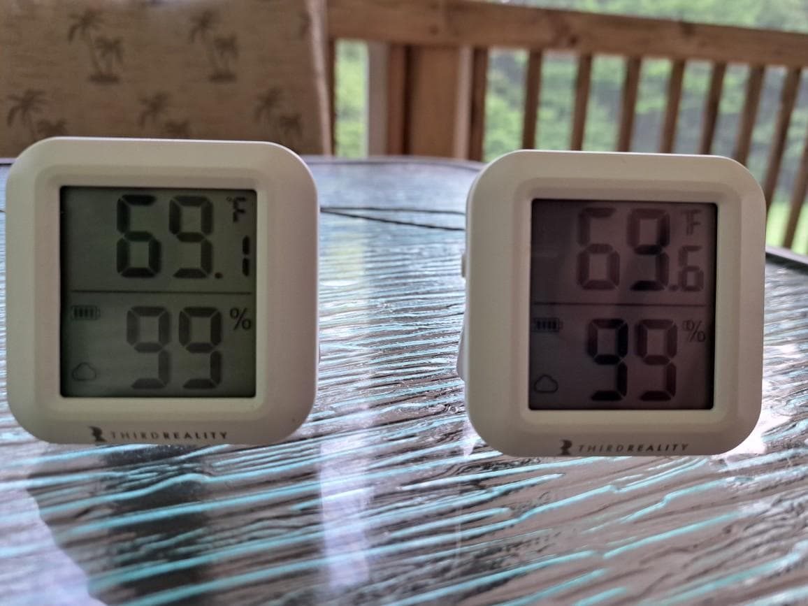

Both of my displays, see picture below, were incorrect this morning.
The real temperature was around 64.
They reported correct temperatures to the hub, as seen in the logs.
Since this is not a one-off, I think @ThirdReality should get involved.

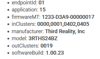

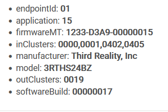

I thought it interesting that "firmwareMT" still has a "15" in it, whereas SoftareBuild has a "17".
I figured, I'd check out device info in the "device" driver.
It came up with "Software Build Id:1.00.23".
Admittedly I don't understand what's going on, but I've had some exposure in the Hue motion problem days.
Hold on, this is what I'm getting now, a "17" in "firmwareMT", so that's a positive sign.
Kind of what I recall for the Hues: it takes a while, has to do something or other before the "Data" gets updated.

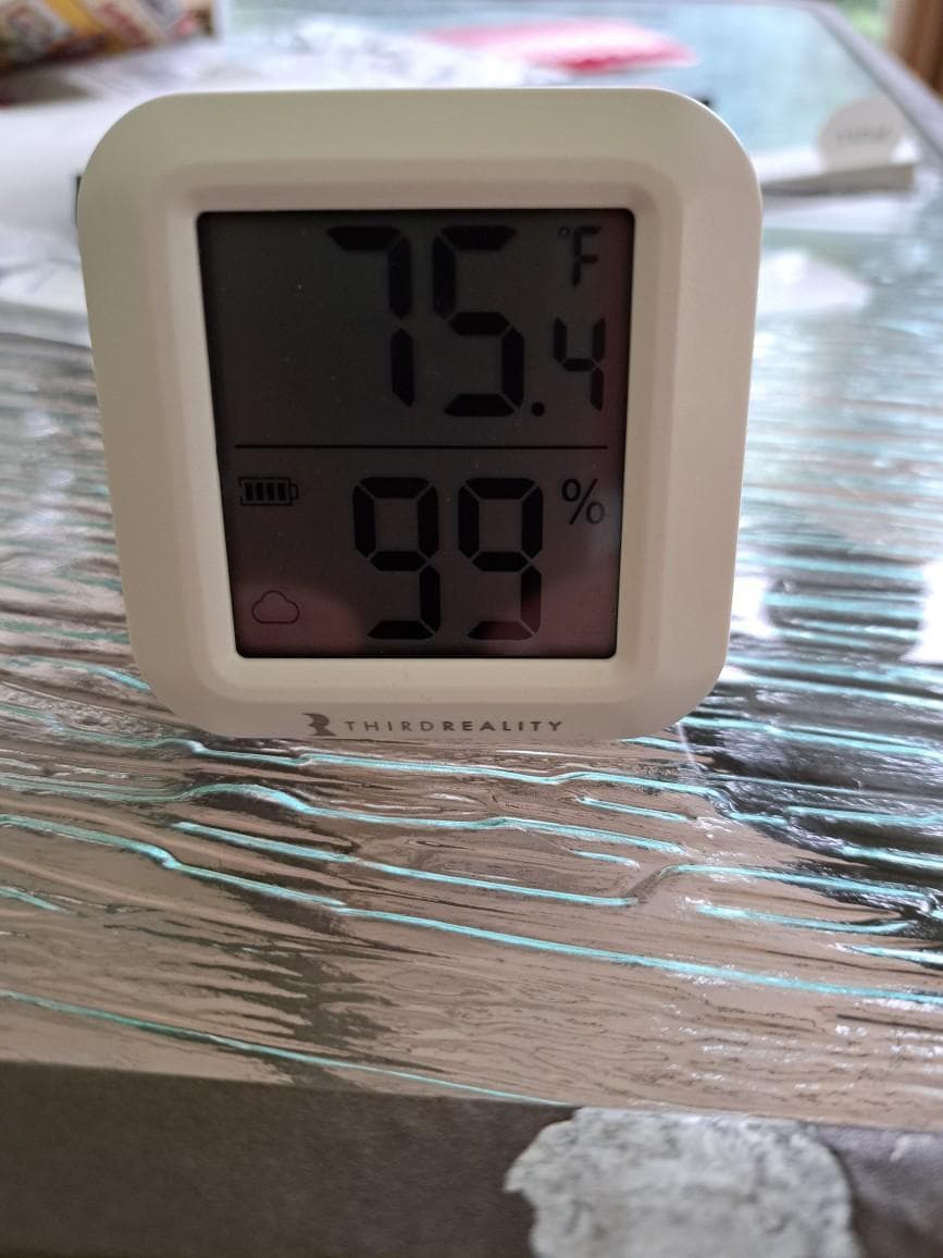

I'm happy to report that the firmware fix appears to work.
I am looking at the display right now, 99% humidity, and the log agrees with the changing temperature.
