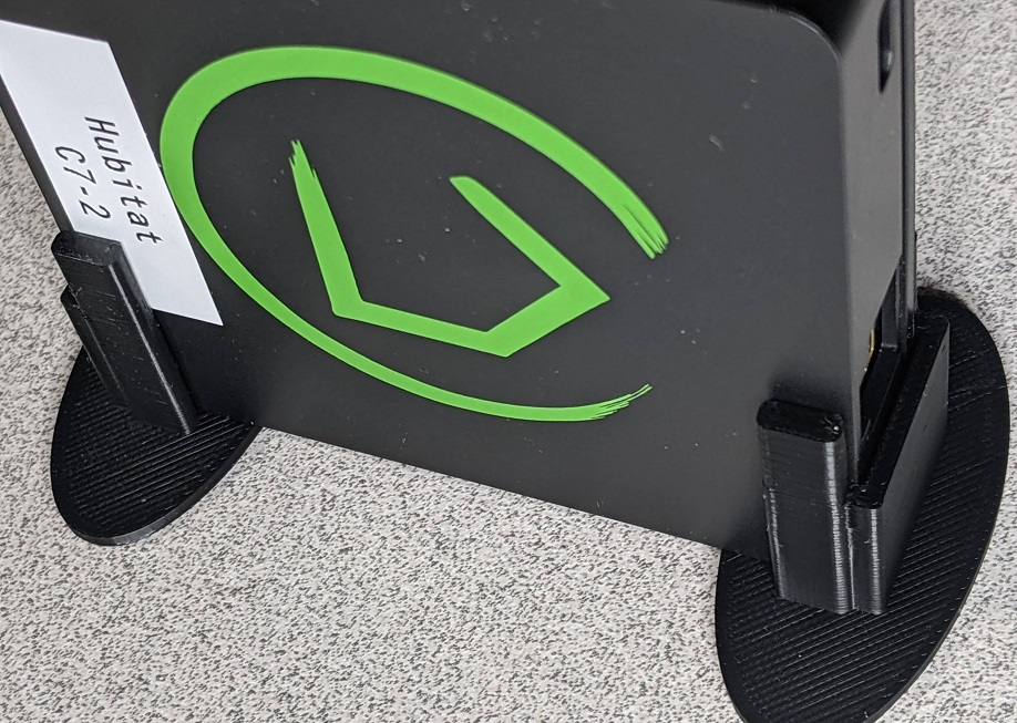

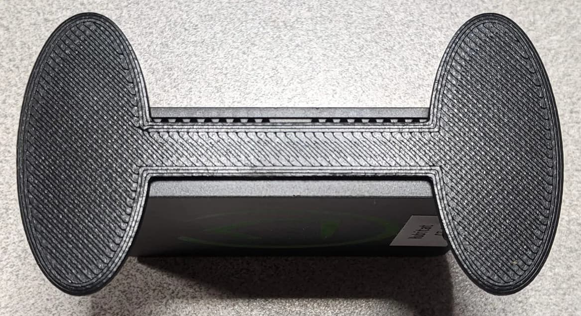

Ah...see, I need the extra space behind the tablet since I ran my power cables through the wall.

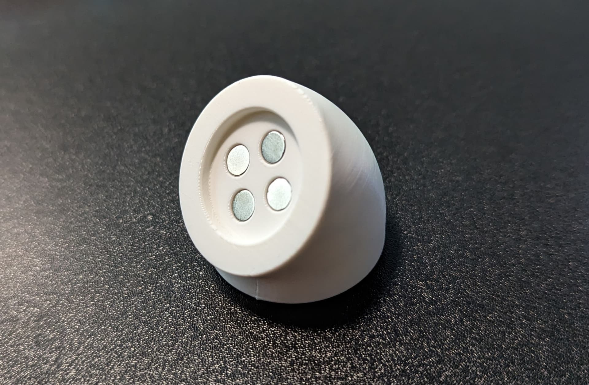

Linptech mmWave ES1 angled sensor mount. Also posted to the Linptech driver page, but wanted to reference it here as well. More info on the printables page: https://www.printables.com/model/766959-limptech-mmwave-angled-sensor-mount
