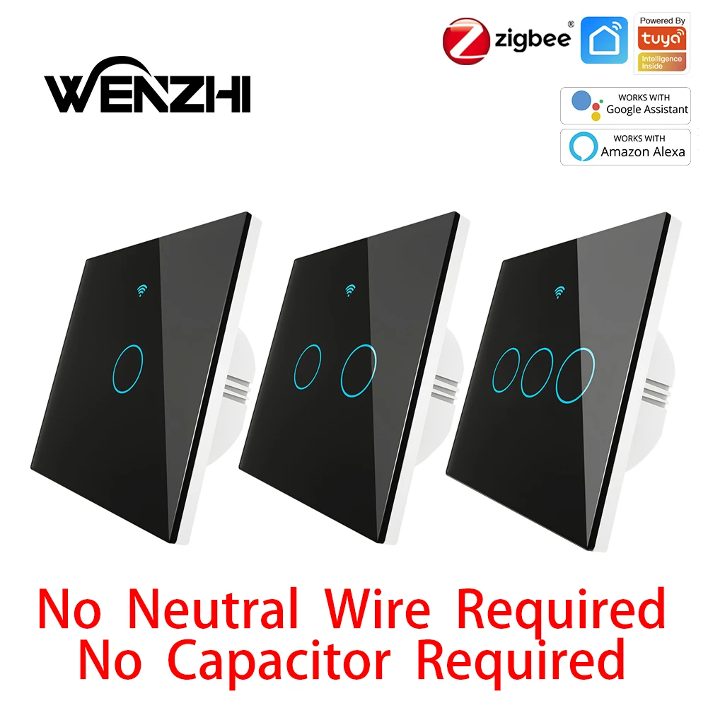

And switches placed on the wall (whether traditional or smart) such as this one:
The latter being my definition of a 'wall plate' :smiley:
Hope that makes more sense?
