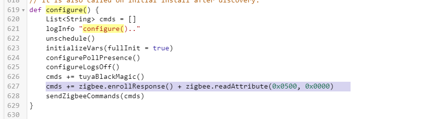

Looking at the debug logs, I don't see an IAS enrollment request or answer from the device.'
Can you try adding this to the configure() :
cmds += zigbee.enrollResponse() + zigbee.readAttribute(0x0500, 0x0000)
Summary
Should look like this:

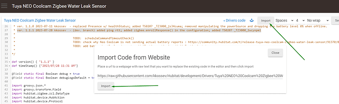

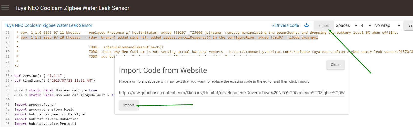

Update: The change above is in the latest dev.branch version 1.1.1 - you can update it using the Import button from HE code editor:

dev:5012023-07-28 08:44:05.813infoTuya NEO Coolcam Zigbee Water Leak Sensor configure()..
dev:5012023-07-28 08:44:05.808infoTuya NEO Coolcam Zigbee Water Leak Sensor Tuya NEO Coolcam Zigbee Water Leak Sensor installed()... driver version 1.1.1 2023/07/28 11:31 AM
sys:12023-07-28 08:44:00.139infoInitializing Zigbee Device A4C138A99A415B1E, 85BB
sys:12023-07-28 08:43:56.665infoZigbee Discovery Running
