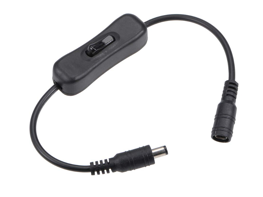

Worst case you might want to make use of some sort of adapter with a switch to go between the power brick and the strip's controller.
e.g. uxcell DC 12V Inline Rocker On/Off Switch with 5.5 x 2.1mm DC Jack Male to Female Power Cable for LED Strip Light CCTV Camera Black

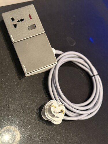

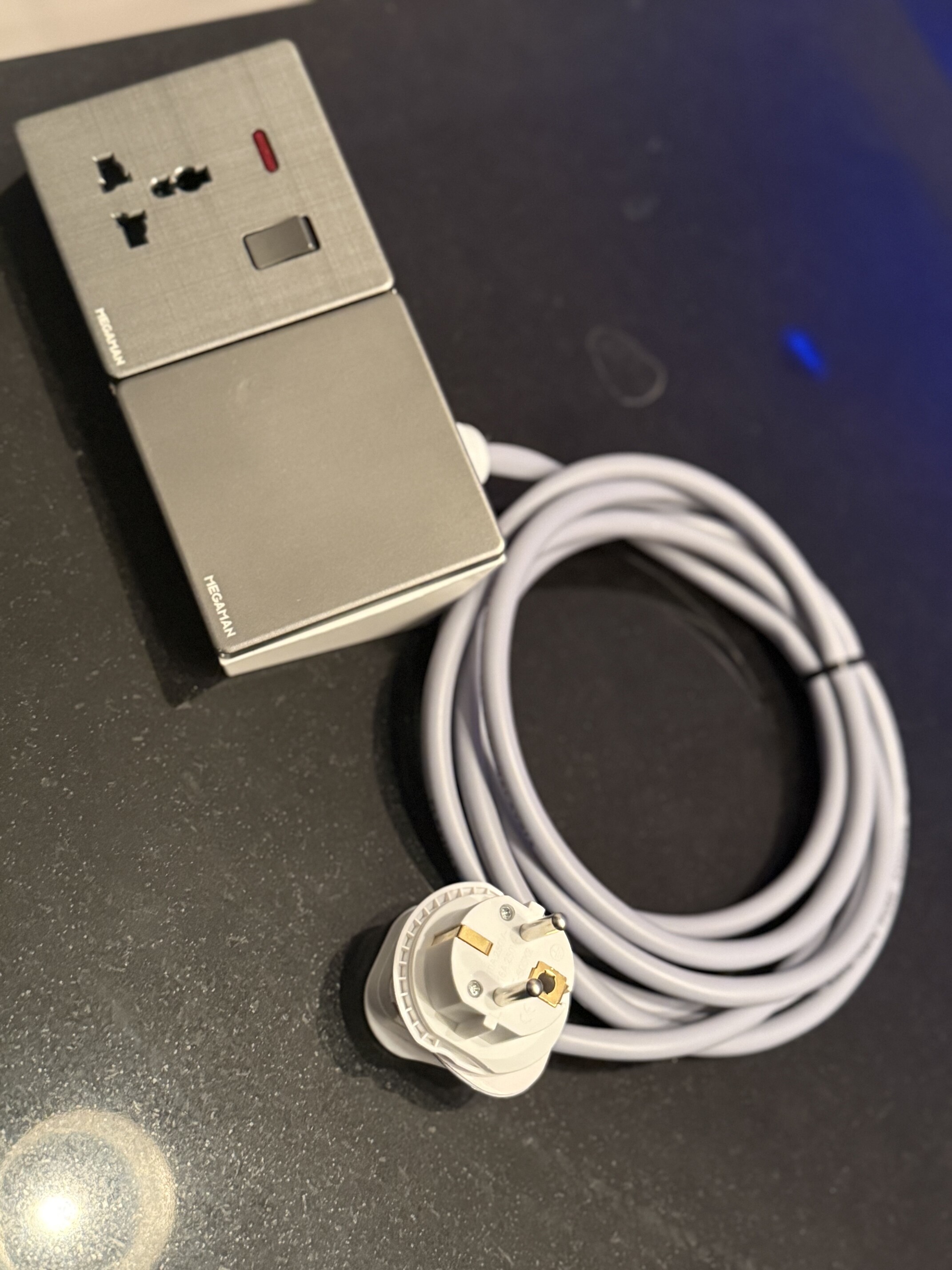

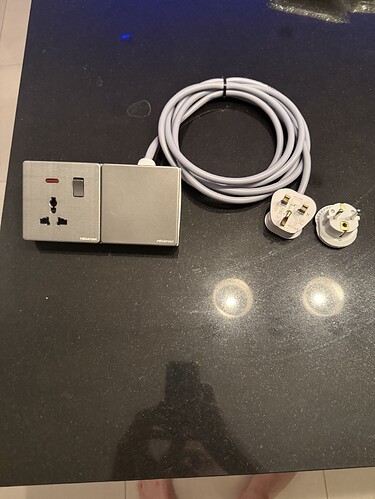

I made an extension cord using a zwave relay.
The power input is a uk style male plug with 3 prongs. Power. Neutral and ground is connected to a zwave relay. The output is sent to a uk style 3 prong outlet. Power ground and neutral.
The outlets in Thailand are also 3 plug but a different style than the UK. I ordered some adapters so I can plug the device in to the outlets here in Thailand. But the adapters I ordered were only 2 prong. So no dedicated ground.
My initial question was how will the relay (which has a ground), react if connected to mains with no ground. Don’t want to fry my relay.

Would have to make one ! That Sylvaina has a weather proof 2 prong barrel connector. But. Way easier to insert : remove that vs pushing in and pulling out the plug. And instant power off when pulling the barrel plug out. Those 24v supplies take half a sec to fully drain the energy.

It won’t react at all, and under normal circumstances you wouldn’t know there’s a difference because the ground wire carries no current.
But defeating a ground pin introduces safety concerns if, for example, you plug in a toaster that happens to have a live wire loose inside and comes in contact with the (metal) case.
Normally that kind of fault would, via the ground wire, trip the circuit breaker. But not if the ground pin was disconnected at the outlet by an adapter.

Sounds safe enough to get them set up and make sure they are working. Most of my furniture is going to be in a sea container for 2 months so really won’t be using them until my stuff arrives anyway. But I’ll find the proper adapters that has the ground pin. Until I can rewire the plug to the proper Thai one.
