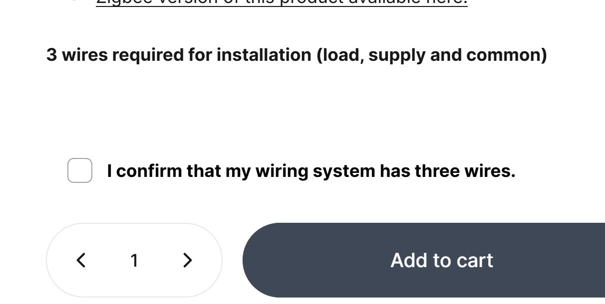

I will message Sinope, but this is what they have on their Product Page:
You actually need to check a box before adding to your cart!
This is their Low VOltage Thermostat:
They do technically sell a 2 wire Zigbee thermostat, but it specifcally states that it is for electric baseboard heaters, so not clear if this compatible for a Low Voltage setup.
I knew I saw it somewhere, but could remember where exactly.
Those are for 120V/240V baseboards only
