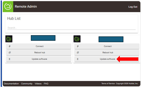

I had this issue as well. I found if you update software from the remote admin section it works fine.. Bringing up the HE GUI was what was blocking my update.
This method worked. I've never had this issue before. Maybe it's related to being a major update? Although I've done those before.
