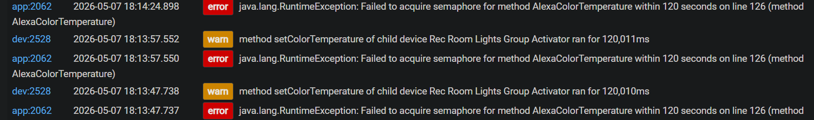

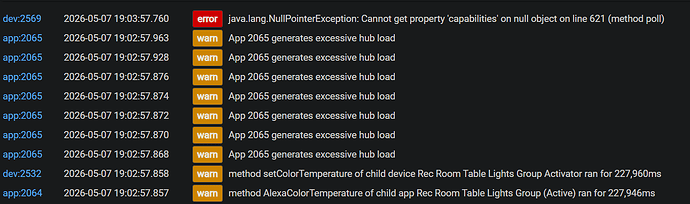

Not quite sure where this is coming from but it's new on this build.
From Room Lighting app and Govee Integration. @mavrrick58
I'll investigate more or roll back if it continues; not much time to fiddle right now.

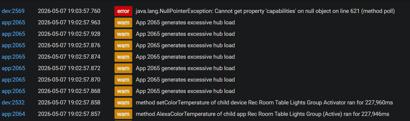

I rebooted and have this so far:
Before reboot, pages of errors:
Rolling back to .134. Reboot is a mess in the logs so that didn't help.

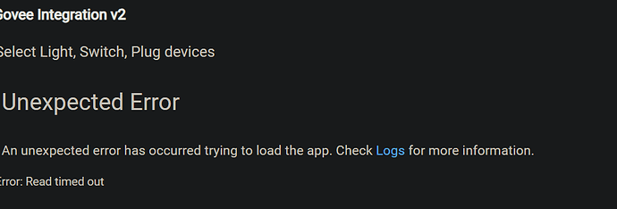

Still there now so maybe a Govee back end thing?
These errors are all bulbs that are fin in the Govee app on my phone.
May have to disable something so stop the errors.

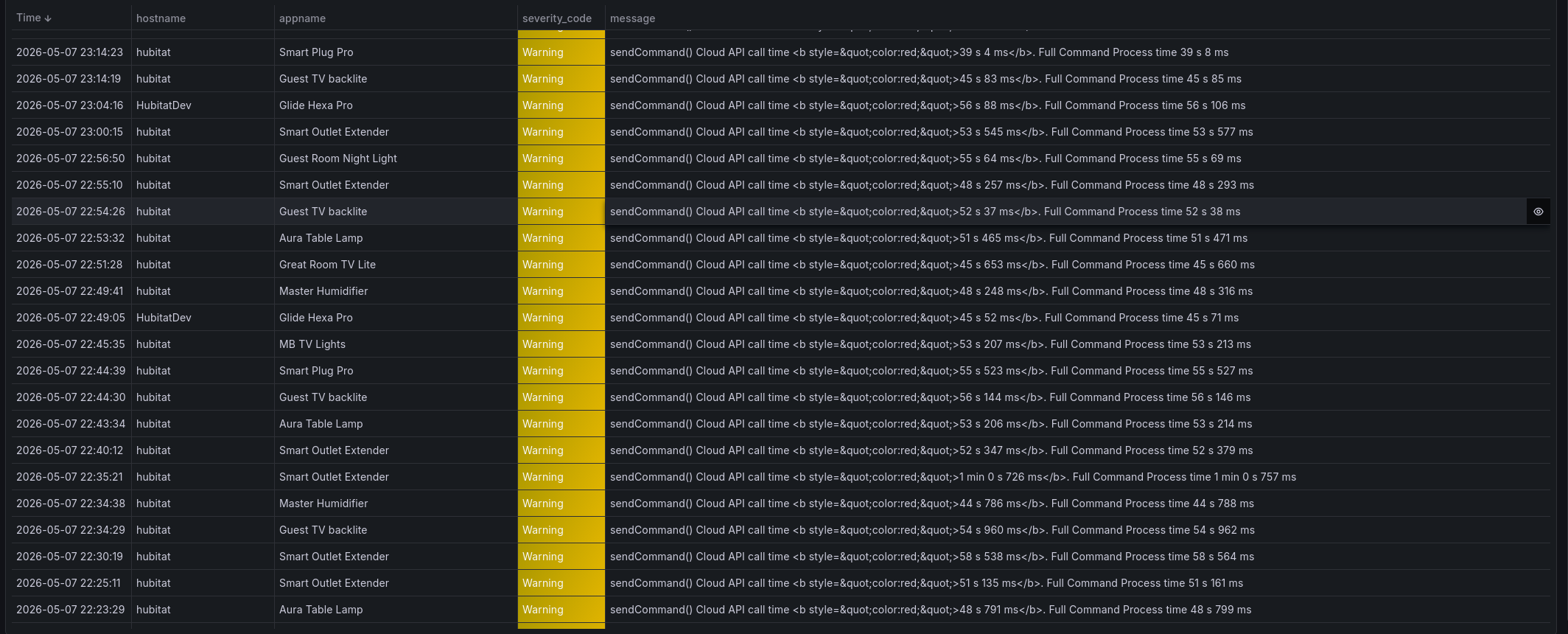

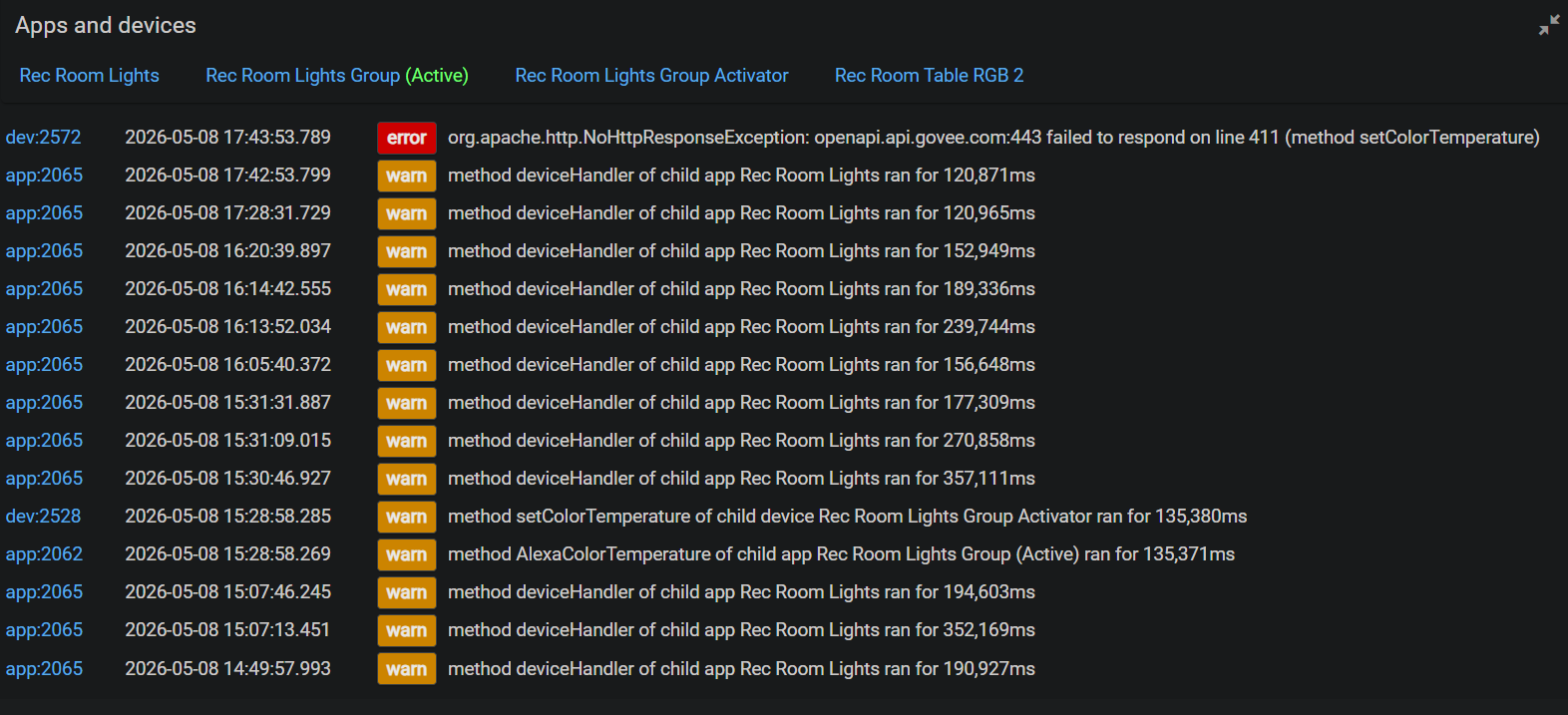

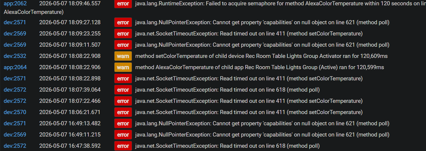

Here is a snippit from my Syslog Dashboard that just shows the sendCommand message from my hubs. Any time a Cloud API Call goes over 10 seconds it generates one of these messages. Some of them in the worst time last night were over 1 min. I also had many Timeout failures as well around those 1 min calls. Those are similar to what @dnickel had above.
There is no doubt Govee had some major issues last night, They are better today, but it is still not perfect. This also highlights I need to do better with handling these failures. i guess i know what my next update will be.

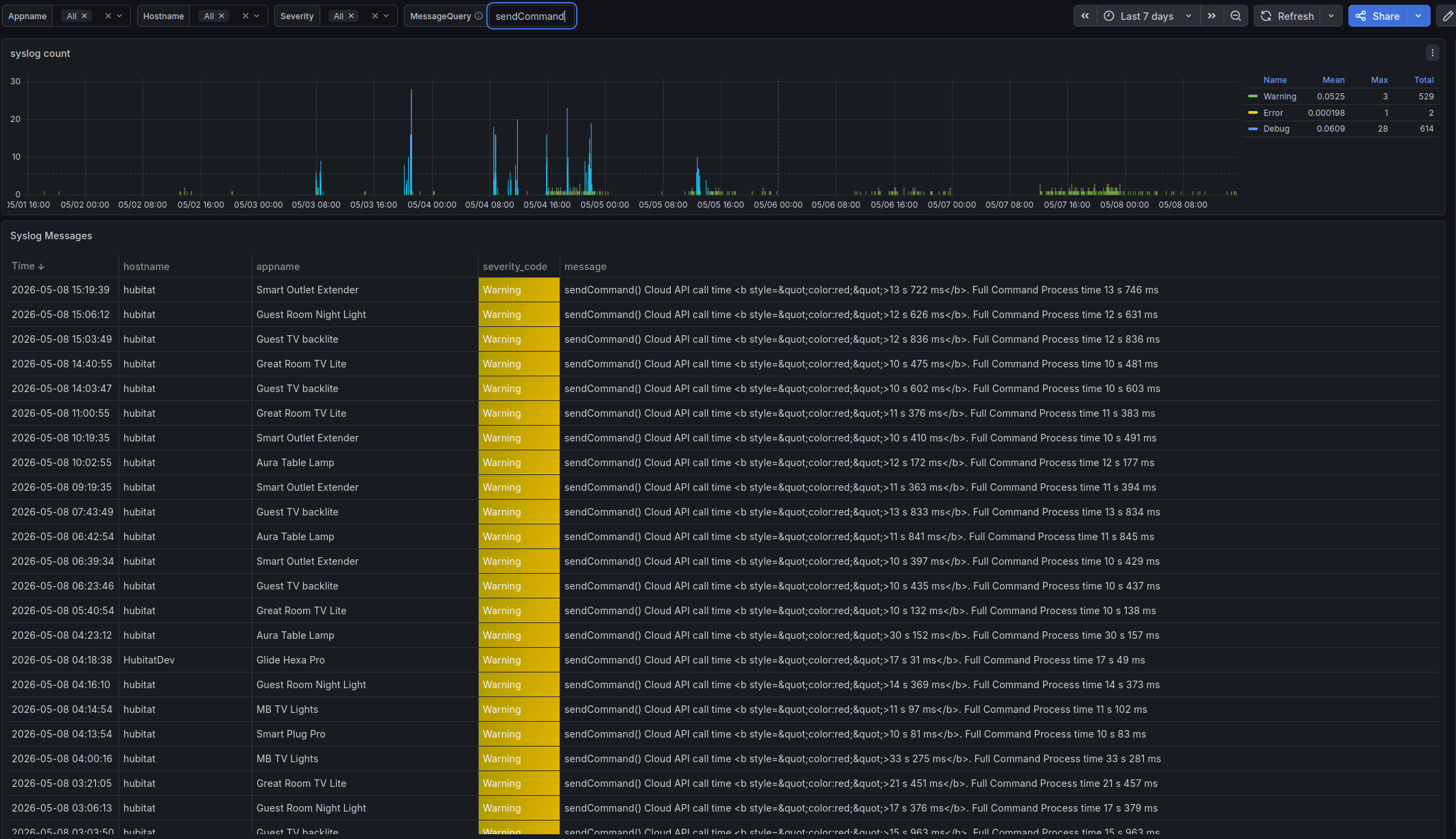

Here you can see the worst times were the calls were around or over 1 min or just outright failing.
