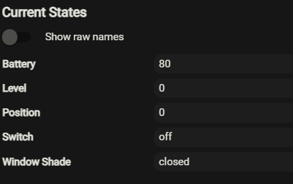

  • Fix for ZWave-JS iBlinds not reporting on internal driver. Still an issue.

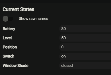

I have tested the HE driver and logged the ZW messages. Does not report status on Dashboard when closed. Left is built-in, right is iBlinds community driver.
Current state shows Position 0 (closed) but Level is at 50?
Under commuity driver states are correct
HE Current States
HE Blind Close Command

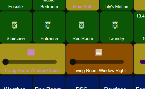

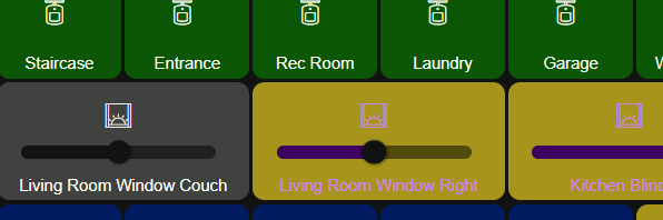

Testing .135 and blind with the HE driver fails the Dashboard update.
Tile incorrect after Refresh Command

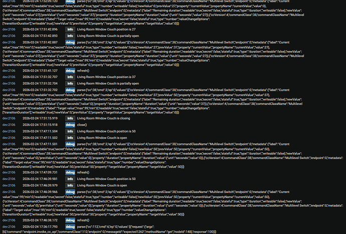

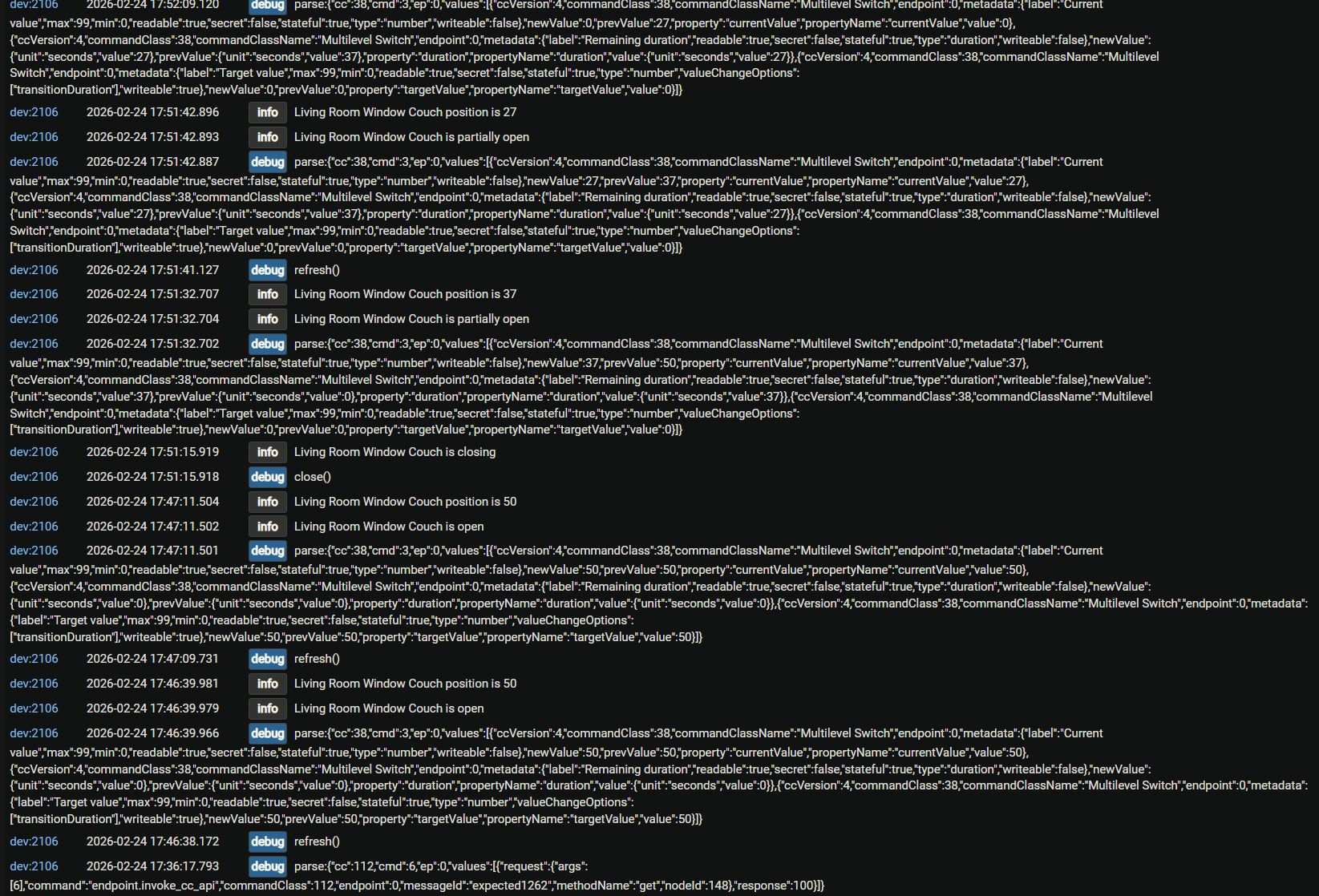

I tried a Close Command and the wife called out, "the blind is going wild".
I put a debug trace on her but no response. Typical. :crazy_face:
Trace of the "wild" blind.

2026-02-24 17:51:42.369|CNTRLR   [Node 148] [~] [Multilevel Switch] targetValue: 0 => 0            [Endpoint 0]
2026-02-24 17:51:42.367|CNTRLR   [Node 148] [~] [Multilevel Switch] duration: {"value":37,"unit":" [Endpoint 0] -                                  seconds"} => {"value":27,"unit":"seconds"}
2026-02-24 17:51:42.364|CNTRLR   [Node 148] [~] [Multilevel Switch] currentValue: 37 => 27         [Endpoint 0]
2026-02-24 17:51:42.364|SERIAL » [ACK]                                                                   (0x06)
2026-02-24 17:51:42.361|SERIAL « 0x011300a800000100940526031b001b00b3007f7f42                        (21 bytes)
2026-02-24 17:51:42.357|DRIVER « [REQ] [SendDataBridge] -                                    callback id:            153 -                                    transmit status:        OK, took 1190 ms -                                    routing attempts:       1 -                                    protocol & route speed: Z-Wave, 40 kbit/s -                                    routing scheme:         LWR -                                    ACK RSSI:               -77 dBm -                                    ACK channel no.:        1 -                                    TX channel no.:         1 -                                    beam:                   1000 ms
2026-02-24 17:51:42.355|SERIAL » [ACK]                                                                   (0x06)
2026-02-24 17:51:42.352|SERIAL « 0x011d00a99900007700b37f7f7f7f01010300000000420100007f7f7f7f7f29    (31 bytes)
2026-02-24 17:51:41.159|DRIVER « [RES] [SendDataBridge] -                                    was sent: true
2026-02-24 17:51:41.156|SERIAL » [ACK]                                                                   (0x06)
2026-02-24 17:51:41.150|SERIAL « 0x010401a90152                                                       (6 bytes)
2026-02-24 17:51:41.147|SERIAL « [ACK]                                                                   (0x06)
2026-02-24 17:51:41.140|SERIAL » 0x011000a90001009402260225000000009949                              (18 bytes)
2026-02-24 17:51:41.138|DRIVER » [Node 148] [REQ] [SendDataBridge] -                                  │ source node id:   1 -                                  │ transmit options: 0x25 -                                  │ callback id:      153 -                                  └─[MultilevelSwitchCCGet]
2026-02-24 17:51:41.137|DRIVER   one or more queues busy
2026-02-24 17:51:32.198|DRIVER   all queues idle
2026-02-24 17:51:32.196|DRIVER « [Node 148] [REQ] [BridgeApplicationCommand] -                                  │ RSSI: -78 dBm -                                  └─[MultilevelSwitchCCReport] -                                      current value: 37 -                                      target value:  0 -                                      duration:      37s
2026-02-24 17:51:32.193|CNTRLR   [Node 148] [~] [Multilevel Switch] targetValue: 0 => 0            [Endpoint 0]
2026-02-24 17:51:32.190|CNTRLR   [Node 148] [~] [Multilevel Switch] duration: {"value":0,"unit":"s [Endpoint 0] -                                  econds"} => {"value":37,"unit":"seconds"}
2026-02-24 17:51:32.188|CNTRLR   [Node 148] [~] [Multilevel Switch] currentValue: 50 => 37         [Endpoint 0]
2026-02-24 17:51:32.187|SERIAL » [ACK]                                                                   (0x06)
2026-02-24 17:51:32.185|SERIAL « 0x011300a8000001009405260325002500b2007f7f43                        (21 bytes)
2026-02-24 17:51:32.181|DRIVER « [REQ] [SendDataBridge] -                                    callback id:            152 -                                    transmit status:        OK, took 1200 ms -                                    routing attempts:       1 -                                    protocol & route speed: Z-Wave, 40 kbit/s -                                    routing scheme:         LWR -                                    ACK RSSI:               -78 dBm -                                    ACK channel no.:        1 -                                    TX channel no.:         1 -                                    beam:                   1000 ms
2026-02-24 17:51:32.179|SERIAL » [ACK]                                                                   (0x06)
2026-02-24 17:51:32.178|SERIAL « 0x011d00a99800007800b27f7f7f7f01010300000000420100007f7f7f7f7f26    (31 bytes)
2026-02-24 17:51:30.964|DRIVER « [RES] [SendDataBridge] -                                    was sent: true
2026-02-24 17:51:30.962|SERIAL « 0x010401a90152                                                       (6 bytes)
2026-02-24 17:51:30.958|SERIAL « [ACK]                                                                   (0x06)
2026-02-24 17:51:30.954|SERIAL » 0x011000a90001009402260225000000009848                              (18 bytes)
2026-02-24 17:51:30.953|DRIVER » [Node 148] [REQ] [SendDataBridge] -                                  │ source node id:   1 -                                  │ transmit options: 0x25 -                                  │ callback id:      152 -                                  └─[MultilevelSwitchCCGet]
2026-02-24 17:51:30.949|DRIVER   one or more queues busy
2026-02-24 17:51:28.116|CNTRLR   [Node 183] [~] [Meter] value[66049]: 0.3 => 0.3                   [Endpoint 1]
2026-02-24 17:51:28.115|CNTRLR   [Node 183] [Meter] value[66049]: metadata updated                 [Endpoint 1]
2026-02-24 17:51:28.094|SERIAL « 0x012100a800000100b713600d0100320221740000012c003c0000012c0000b1007 (35 bytes) -                                  f7f57
2026-02-24 17:51:27.013|DRIVER   all queues idle
2026-02-24 17:51:27.010|SERIAL » [ACK]                                                                   (0x06)
2026-02-24 17:51:27.007|SERIAL « 0x0107013b9f9d9da5f8                                                 (9 bytes)
2026-02-24 17:51:27.003|SERIAL « [ACK]                                                                   (0x06)
2026-02-24 17:51:27.000|SERIAL » 0x0103003bc7                                                         (5 bytes)
2026-02-24 17:51:26.998|DRIVER   one or more queues busy
2026-02-24 17:51:17.235|DRIVER   all queues idle
2026-02-24 17:51:17.230|SERIAL » [ACK]                                                                   (0x06)
2026-02-24 17:51:17.227|SERIAL « 0x011300a80000010094056c0296013200b2007f7fad                        (21 bytes)
2026-02-24 17:51:17.213|DRIVER « [REQ] [SendDataBridge] -                                    callback id:            150 -                                    transmit status:        OK, took 1220 ms -                                    routing attempts:       1 -                                    protocol & route speed: Z-Wave, 40 kbit/s -                                    routing scheme:         LWR -                                    ACK RSSI:               -78 dBm -                                    ACK channel no.:        1 -                                    TX channel no.:         1 -                                    beam:                   1000 ms
2026-02-24 17:51:17.212|SERIAL » [ACK]                                                                   (0x06)
2026-02-24 17:51:17.210|SERIAL « 0x011d00a99600007a00b27f7f7f7f01010300000000420100007f7f7f7f7f2a    (31 bytes)
2026-02-24 17:51:15.963|DRIVER « [RES] [SendDataBridge] -                                    was sent: true
2026-02-24 17:51:15.960|SERIAL » [ACK]                                                                   (0x06)
2026-02-24 17:51:15.957|SERIAL « 0x010401a90152                                                       (6 bytes)
2026-02-24 17:51:15.953|SERIAL « [ACK]                                                                   (0x06)
2026-02-24 17:51:15.948|SERIAL » 0x011600a900010094086c019604260100ff25000000009649                  (24 bytes)
2026-02-24 17:51:15.945|DRIVER » [Node 148] [REQ] [SendDataBridge] -                                  │ source node id:   1 -                                  │ transmit options: 0x25 -                                  │ callback id:      150 -                                  └─[SupervisionCCGet] -                                    │ session id:      22 -                                    │ request updates: true -                                    └─[MultilevelSwitchCCSet] -                                        target value: 0
2026-02-24 17:51:15.940|DRIVER   one or more queues busy
Logs from the device driver.
