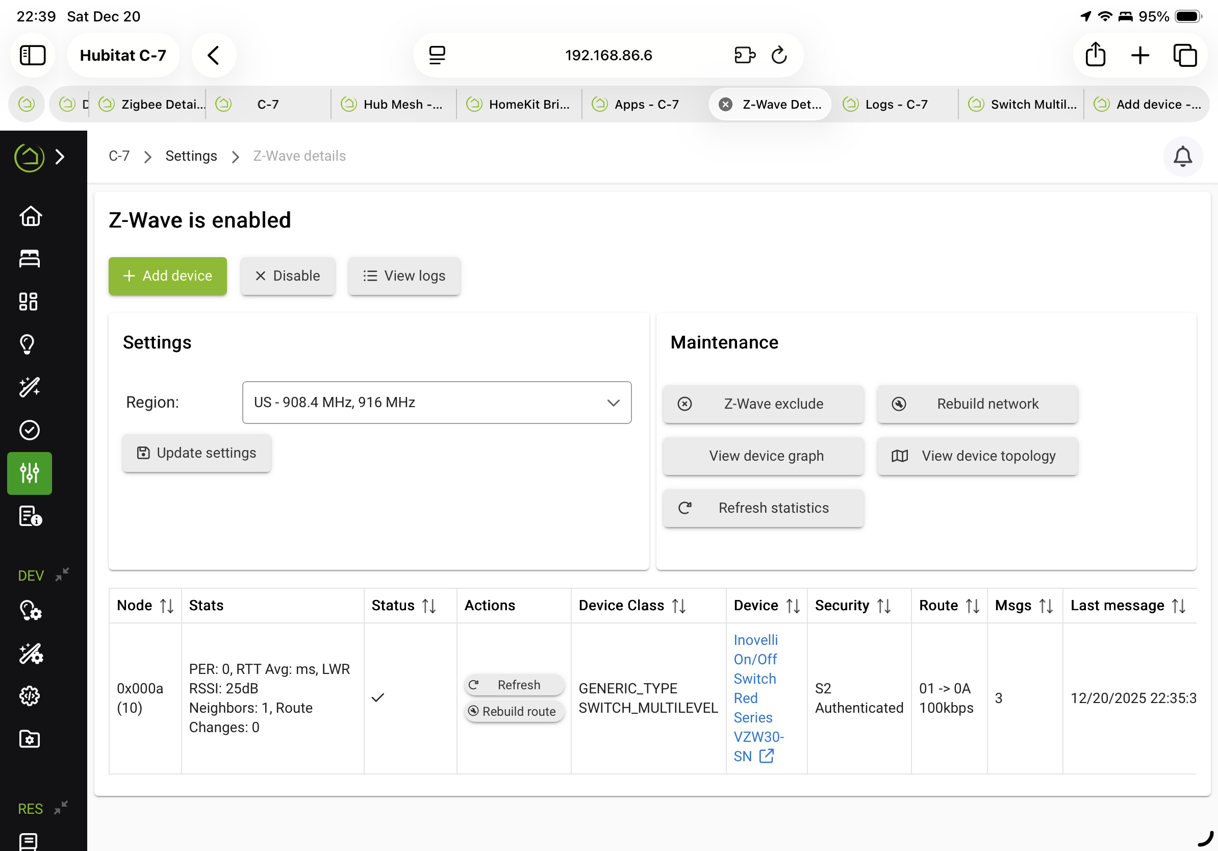

[2.4.3.172] Changing Region to US-LR doesn’t stick [C7]

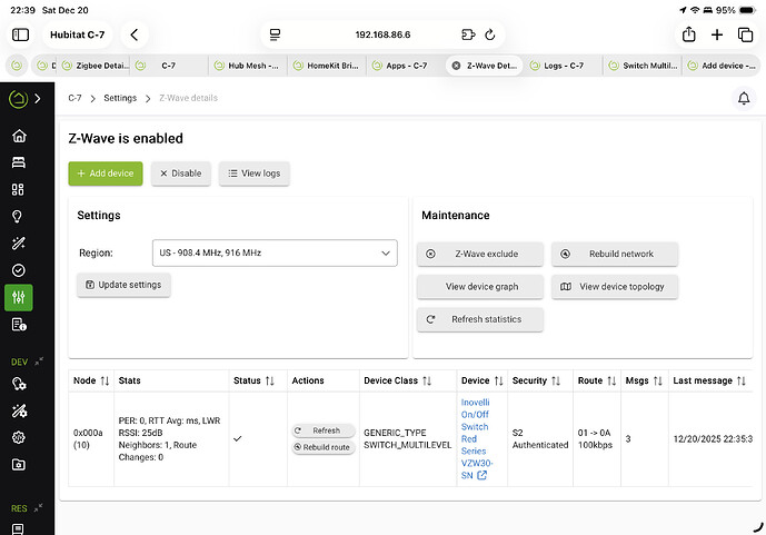

Changing the « Region » setting from « US …» to « US-LR …» works, but the drop-down still displays « US … » after the change.
As can be seen on the screenshot above, the region is set to « US … » but there is a LR device paired to the hub.

I noticed that before I included any devices, I could change z-wave. After device inclusion I no longer could. C8pro. You only have one device so far. See what happens if you exclude it then try to change the z-wave.
Tried that - unfortunately, it remains the same - « US… », no LR.

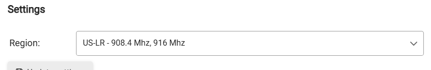

I'm good on my C8-Pro and C8:
C7 also shows as you do, non-LR, and also resists changing to LR. on .172 as well...
Yea, it seems to be a C-7 issue…

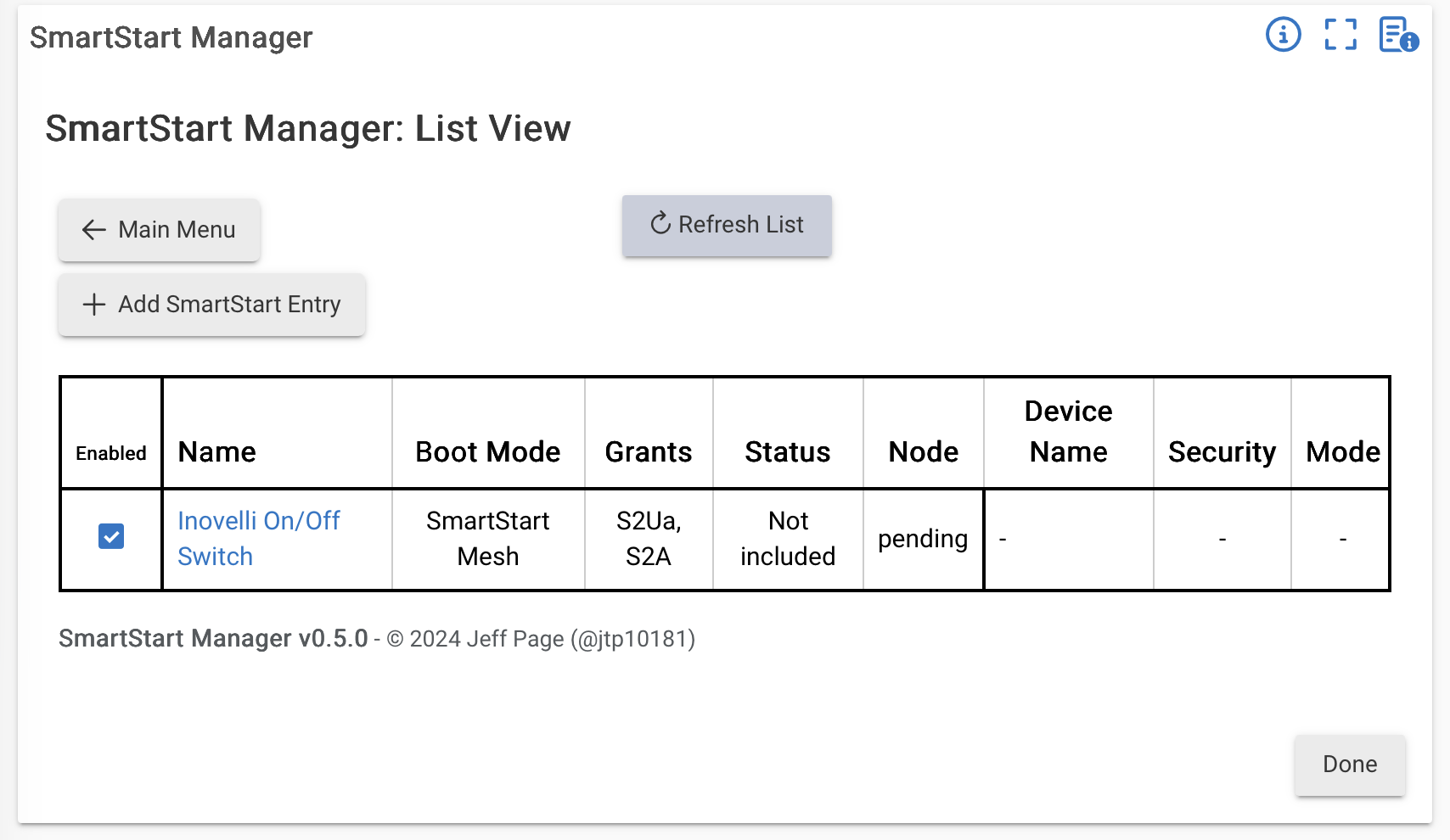

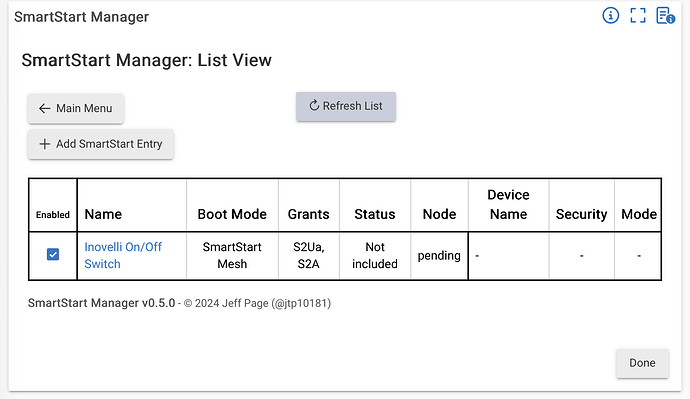

That's interesting! Legacy Z-Wave on the C-7 (and the newer model, maybe?), I assume? The QR code should prefer LR by default if supported by the device, but AFAIK, the hub is supposed to resort to traditional inclusion if it doesn't. I'd be curious if you manually edit the type (the mobile app lets you do this; Jeff's custom app makes it a bit easier after the fact) if that has any effect. Probably shouldn't work that way, but might help figure out if that's it! (I don't think these have any effect on JS.)
Good idea - Jeff’s app! I’ll give that a go! Can’t currently edit with the Mobile app unfortunately…
Had forgotten this...thanks for the reminder. PEBKAC all over again.
@jtp10181’s app allowed me to see and edit the setting. They were set for Mesh. However, the device is not installing for some reason… I’ll likely try a power-off/restart to see if it helps. But will soon switch to another hub since I’ve been spending a bit too much time on this…
