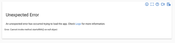

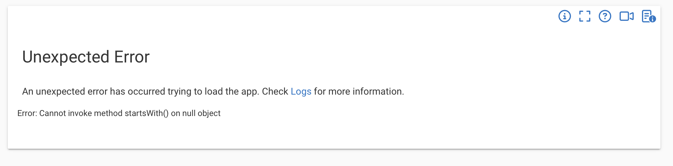

I have a rule that has a condition in the required expression “Not between Date/Time X and Date/Time Y” and that condition references 2 local variables for the Dates/Times. The rule was working fine, but when I clicked into one of the local variables to update it, I received the error “Error: Cannot invoke method startsWith() on null object” (screenshots below). The local local variable did have a past date/time in it, but that hasn’t been an issue in the past. Now I can’t access the rule at all. This issue looks similar to the issue at the following link: Any help fixing this would be appreciated.
When trying to open app:

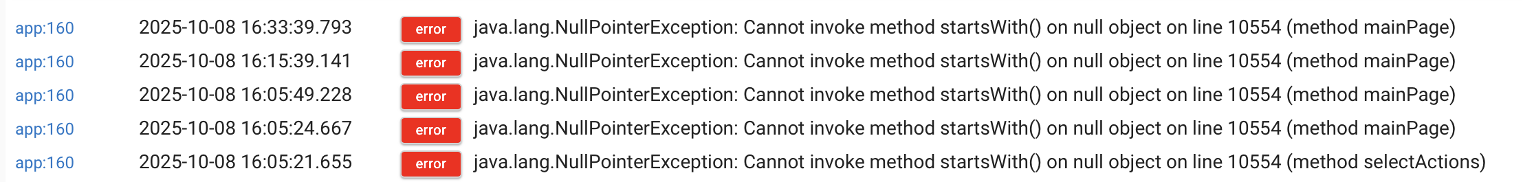

Logs:
In case anyone comes across this or similar issue again where they can't open the app - I fed the error message and an export of the app into ChatGPT (5), and I received an explanation and a fixed app that is working fine now.
