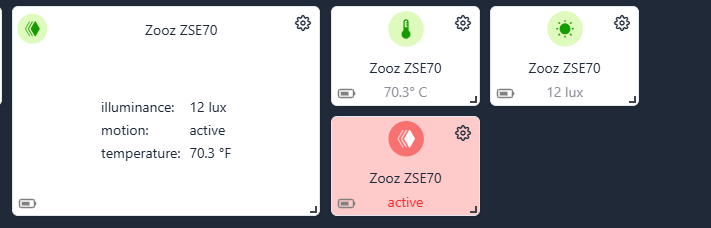

@gopher.ny Just noticed this while making an example for someone. My hub is set to F and the units in the events are F. The MultiSensor shows it as F but the Temp tile shows it as C ?

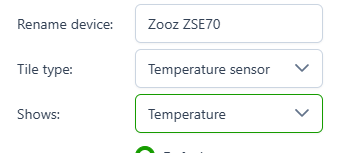

Also in the "shows" box if you leave it blank the units show up (as shown above, possibly wrong) but if you select temp then no units show at all?

Edit: if one picks an attribute, the code no longer "knows" what the units are. That's going to stay as is. The wrong temperature scale bit will be fixed in the next build, though.

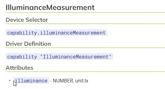

Lux seems to be hard coded since on my driver I have the units as "lx" but it shows as "lux" on the dashboard. What if the illuminance is in percent (like a ZSE40 for example)?

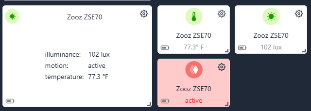

Seems to be working now for the F anyway (I think its a beta version).
BTW the docs say that illuminance units is lx
