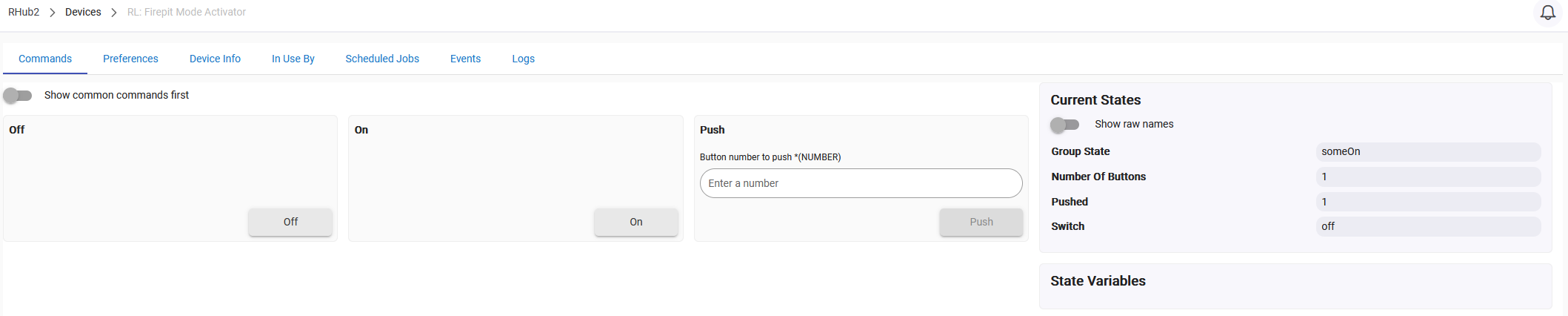

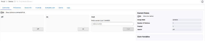

When using a Room Lighting, the state doesn't seem to work consistently.

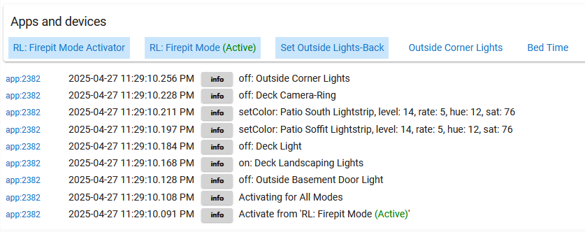

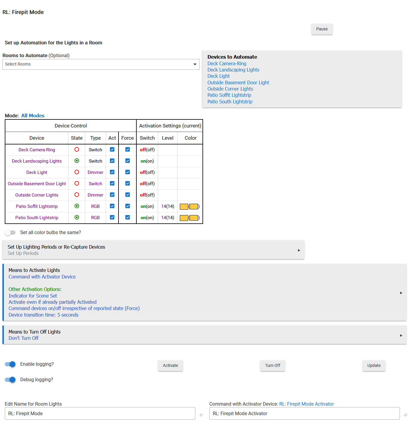

In the following example, notice that every device IS set to the "desired state from the table", yet the RL app isn't marked "(Active)" and the RL Activator Switch is NOT set to "on".
When I activate this RL app, it does briefly show as "Active" on the RL app's settings page, but that only lasts an instant. It doesn't appear that the activator switch turns on at all. Oddly enough, while the "(Active)" notation next to the name in the RL App setting page disappears, it seems to appear in the "title" for the tab and some of the "references" to the RL app.
I'm really just trying to use the "switch" attribute as a way to tell if that RL Scene is really "on" by displaying that on a dashboard--but the switch attribute mostly shows up as "off" (while I'm only showing one example, this seems to be an issue across most/all of my RL apps).
Also note: Sometimes, it seems to work--just not consistently.
