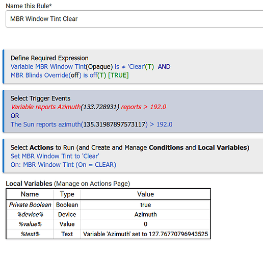

I have 2 rules triggered by a custom attribute (sun azimuth) and they are triggering opposite the designated comparison. I altered one to check and the result is repeatable.
Variable trigger issue may be the root issue?
This has been working flawlessly for 2 years until the last update though.
I'm saying both of the rules use variable triggers, so maybe they share a root cause related to using variable triggers that surfaced in .155/.156? What release are you on?

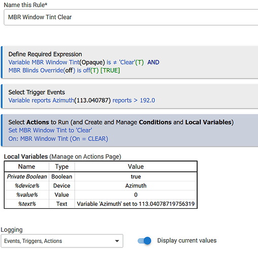

Update: I changed the trigger directly to the custom attribute and it works correctly that way.
That does seem to point a finger...@bravenel will know best, of course.
I will look into this.
This bug found and fixed. Next release....
Fix for this released 2.4.1.157
