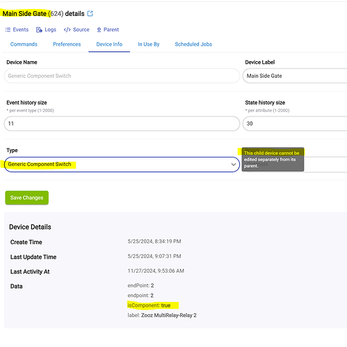

When isComponent: true, then the child device can't be changed by the user.
When isComponent: false, then the child device can changed by the user but the user can select any device .

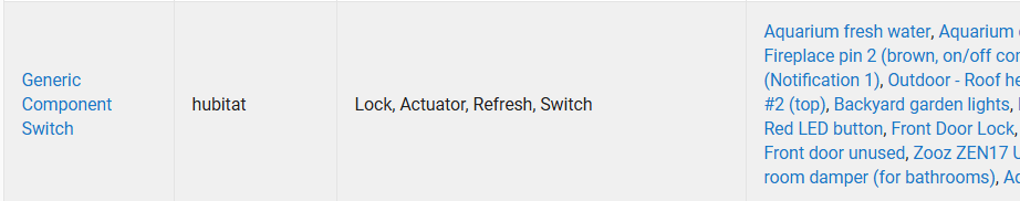

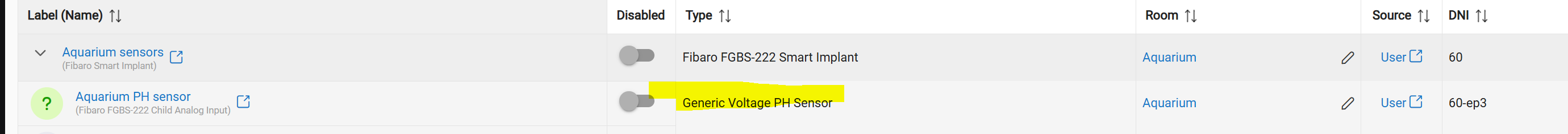

Some context about the use case(s), I have several Zen16, Zen17 relays and recently purchased the Fibaro Smart Implant.
My first issue was controlling a magnetic lock using a Zen16 relay:
This appears as a 'switch' and not a lock. Since 'isComponent: true', I can't modify the device to a 'generic lock'.

Right now, I have this wonky setup where every "Generic Component Switch" has a lock capability. I think it was a suggestion in the forums and has grown into a mess.
