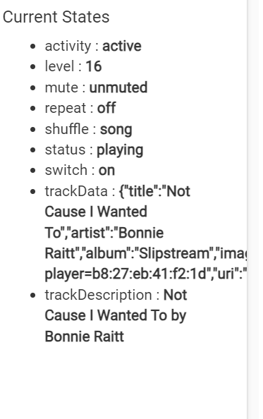

Is the volumeLevel showing in the Current States? If not, adjusting the volume should make it display and stay after refresh.
First screen cap is just going to device page.
Then I tapped the 'volume up' button in the device page...
Second screen cap has the volume added at the bottom...
However, the dashboard still shows the broken tile... missing attribute volume. and still behaves the same after the above as described a couple posts up.
Interesting, the Music Player capability calls for volumeLevel but the Audio Volume wants volume. Add a line identical to the last one with volume instead of volumeLevel.
You cracked it!
like fixed, not broke...
calling it solved. Thanks so much for the help!
