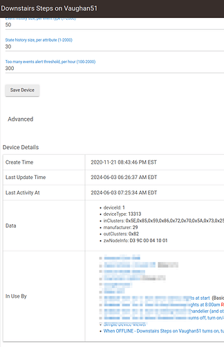

I am in the device page for a simple zwave switch called "Downstairs Steps".
There is a simple Basic Rule that I have : turn on a switch downstairs, when this is turned on (and off). It turned on, but didn't turn off.
Looking at the device page, (screenshot below), it shows that the Downstairs Steps switch has been turned on, but the Basic Rule can't fire because it's offline.
Yet it doesn't show offline???
