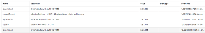

2.3.7.145 Log Purge Doesn't Seem To Work
@gopher.ny
Can confirm, did a rebuild and purge.
Old logs are still there from days ago.
Argh... back to testing.
