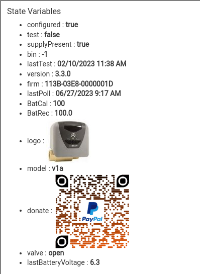

LeakSmart Valve FCC ID: W7Z-ZICM357SP2
tested on firmware
113B-03E8-0000001D (01-1D-01-0A) false mains flag sent
113B-03E8-00000019 valid mains flag

To reset the valve for repairing, rapidly press the center button 5 times. The Blue LED light will begin to flash
indicating it is reset and ready to join.
The device may require a power cycled before a reset. Removing AC adapter and bat. Then power back up.
