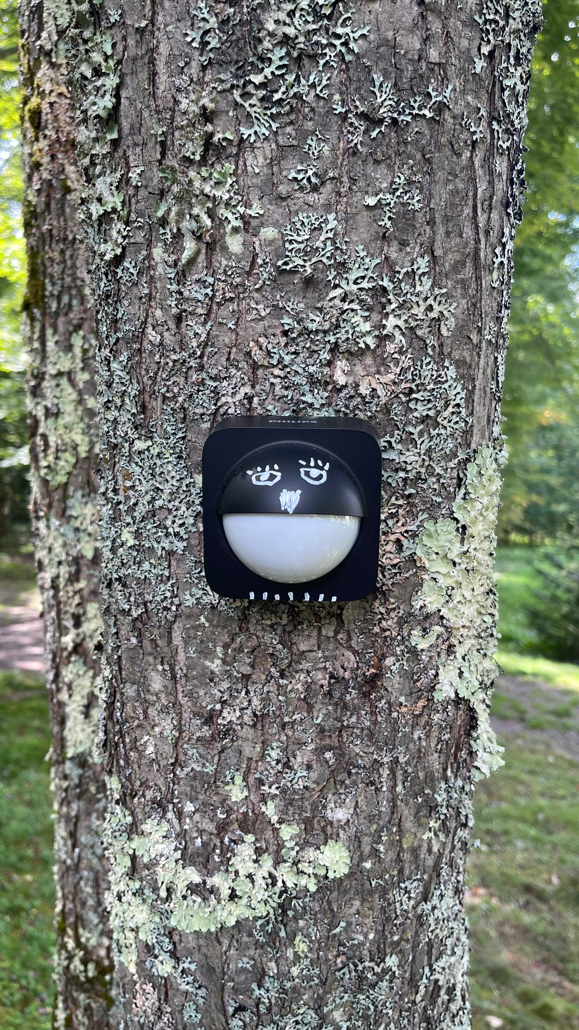

I'm going to chime in here in part to jinx myself. . .
I'd have those sometimes sporadic / sometimes frequent zigbee drops. Six days ago I replaced my first Hue Outdoor sensor with a new one (about 4 years old). While I expect that whether I relate this experience now or later, shortly after doing so I'll get a drop - it's unusual not to encounter one in 6 whole days.
There's a history on that #1 sensor - the white cover was damaged by a Sapsucker about a year ago, and when it rained it would go wonky. It was taken out of service, but earlier this year I had put it into indoor service. It worked well enough, though I'd notice that more than any other sensor it would shine red at times. (I suppose I should mention as well my Hue motion devices are installed in HE, not through the Hue hub). The good news is, the rest of the outdoor sensors have been left alone by the birds, since I painted eyes on the sensor cover above the white plastic. But I digress. . .
Just sharing what may be a relevant anecdote, and testing the jinx factor [shrug]
...bob t
The face painting is FUNNY!
Hard to un-see that!

[chuckle] Each of my 4 outdoor sensors have a personality all their own. Not on purpose, mind you.
...bob t (The Artist Previously Known as He's No Artist)
I have several different manuf. of IR motion sensors and the IR window's shapes do lend themselves to "facial expressions".
I just might do some face painting to give them their own personalities!
Thanks for starting THAT idea!
Maybe this is another thread starter!
Show us your IR motion sensor faces

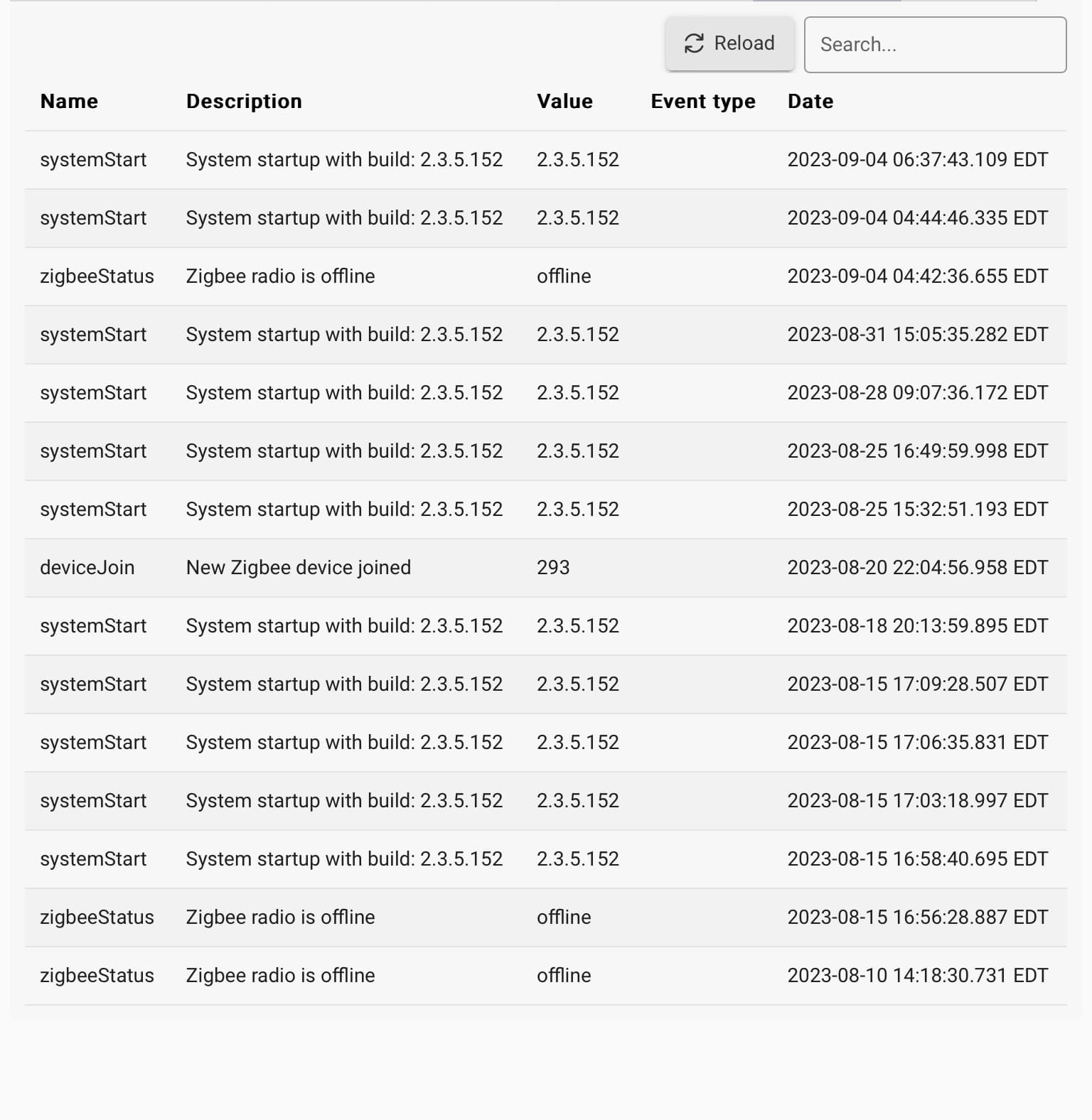

As a followup, a couple things that I noted during this exercise.
- The location log seemed to show a series of events, and there could be long periods between such events.

In my case these periods of zigbee radio disruption appeared as much as 12 hours apart, and ultimately led to a Zigbee Offline notification and typically a power cycle to restore.
Reproducing the error appears to be related to overall network activity, but this is a subjective evaluation.

Well, the alternative is a hub that stops working randomly and doesn’t come back, I don’t have much of a choice to power cycle it. What does it matter if it happens automatically or I get up to unplug it and replug it ?
Understand that this is something that happens every few weeks or so. With a 2-3 weeks cycle, I will be 6 feet under before I can identify the faulty device.
If the unit is still accessible by port 8081 then you will serve nothing but to corrupt the db more. If only the zigbee radio is offline then you will most certainly corrupt doing a dirty shutdown and making things worse. You neee to figure out the cause of the issue but you seem unwilling to go through the diagnostics to do so and also seem to be willing to make it worse by doing dirty shutdowns and risking more corruption.
Sound advice in general. In this case, the problem manifests itself only every two weeks, making this approach impractical. Instead, I spent money to order a third C7 hub. If I get this issue a fourth time, I will replace the hub, changing nothing else. Then, we shall see.

So… I am supposed to keep the hub online forever without a working Zigbee radio ? The Zigbee radio does not come back on its own. I tried rebooting it, it works after 3-4 reboots, maybe, maybe not. I was told that only a power cycle would bring the radio back for sure.
It is not that I am unwilling, it is that going by trial and error will take years. I might as well drop Hubitat if it takes 2 years to diagnose… and I don’t want to do that Hubitat is great when it works. Problems started when the firmware was updated with the new C8 stuff back in March or so.
