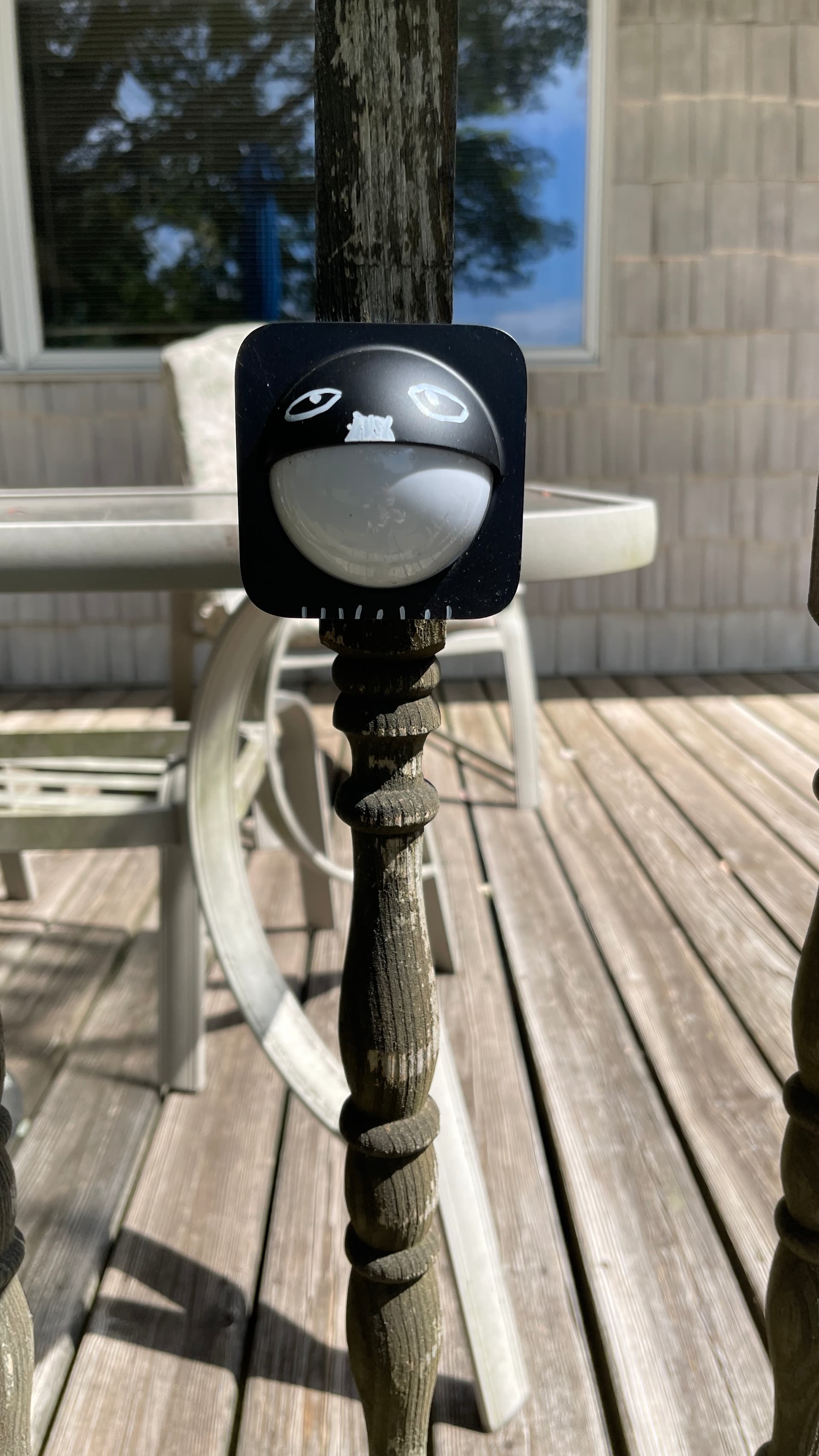

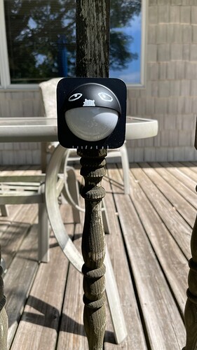

To get started, here's my non-artistic mod to a motion sensor.
Slide it over the PIR to disable the sensor for normal lighting rules operation. Slide it the other way to expose the PIR when I want to override the rules with motion activated full brightness. (i.e. Crafting/hobby time)
Yeah, I know you can do the same thing by putting it back in the box.
But what fun is that? :wink:

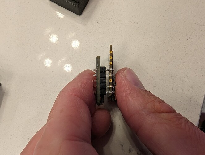

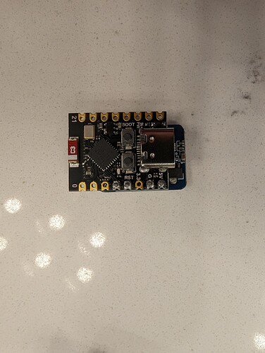

An ESP32 C3 Supermini with an LD2410C radar sensor. The case is about 29mm long and 21.5mm wide.
Cool! What do you use it for?
It's a presence sensor using 24 GHz radar instead of PIR so it doesn't lose tracking when you sit still.

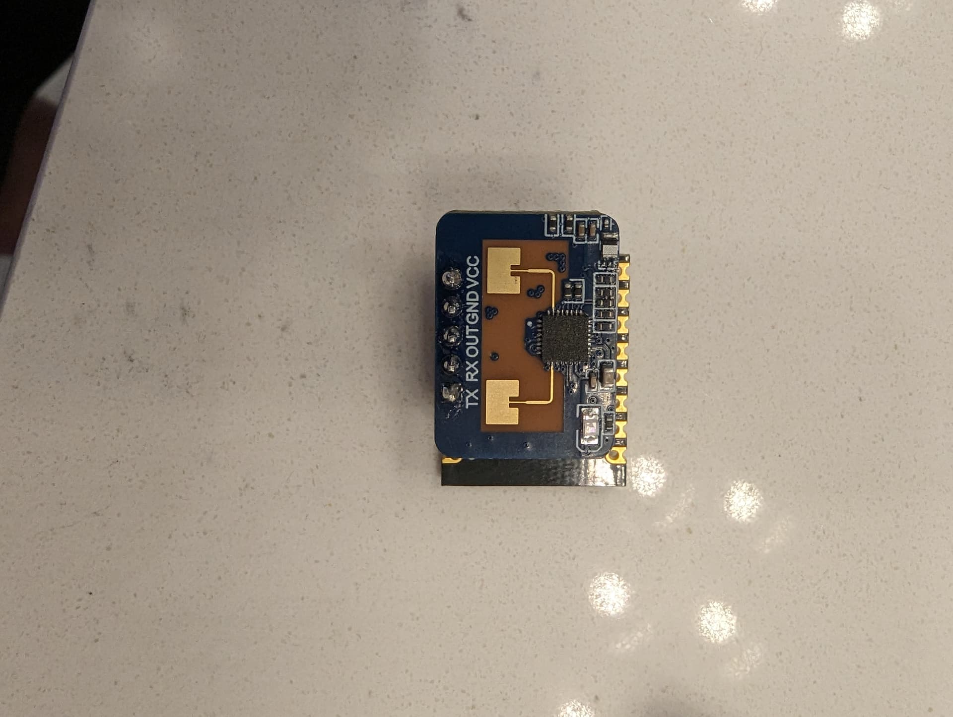

I just purchased a similar board. The "main" IC is a MicRadar T15Bt. What IC is on your board?

It's this ESP board and this radar sensor.
