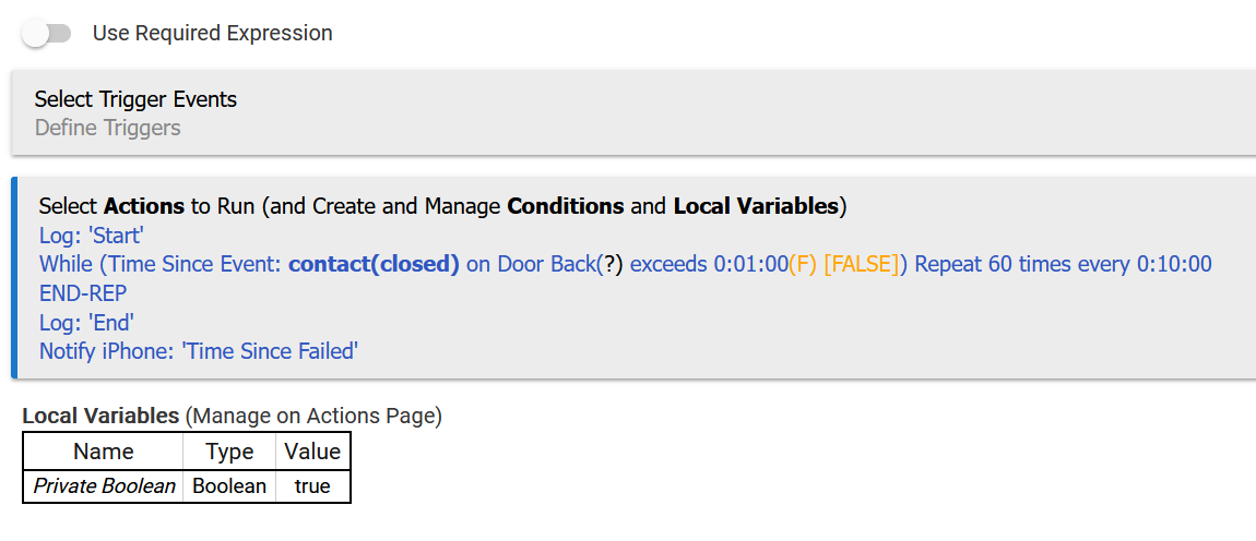

@bravenel I have been experimenting with the Time Since Event and found a possible bug when using it with a contact sensor. When I first select a contact sensor it lists the Time Since as (?). I can reset it by cycling; however, after a while the Time Since changes back to (?). I haven't seen this behavior with motion sensors but haven't spent much time working with them. Here is a rule I created just to test it to the point of failure. Notice the Time Since is reporting (?) after the last run.

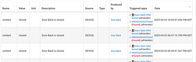

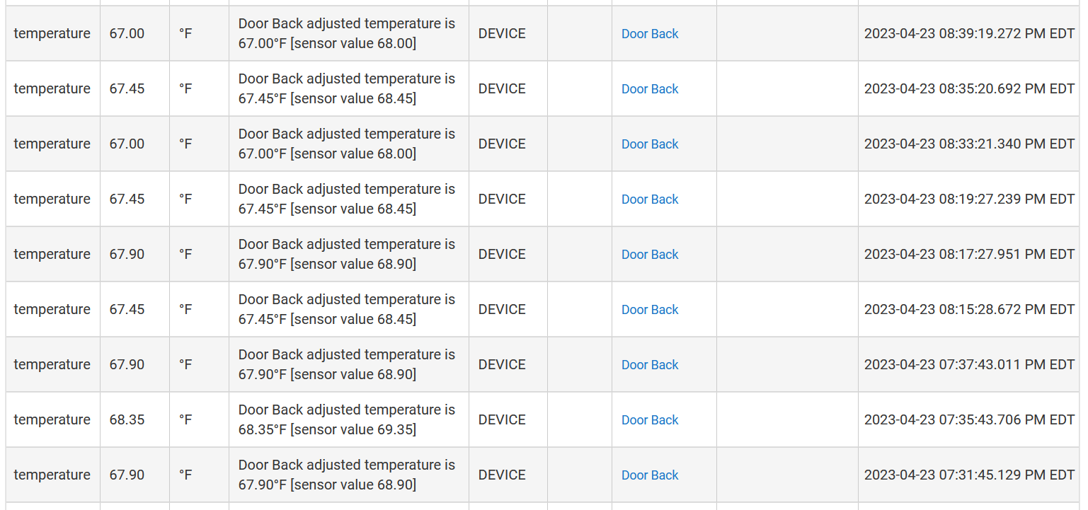

I'm using the built-in Iris V1 Contact Sensor. Here are the events from around the time the "?" was returned.

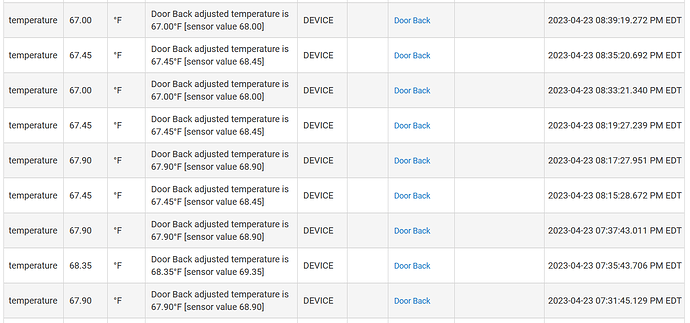

And here are the closed events

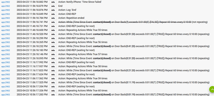

I've run this example three times and it's failed all three times. It's also failing in two other rules (and a second test rule) that I was incorporating Time Since Event into. That's why I created this test rule.

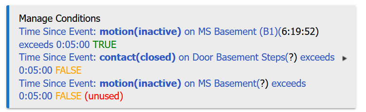

I also have another test rule where the motion went inactive and the contact closed within a minute or two of each other. The motion is still valid many hours later.
