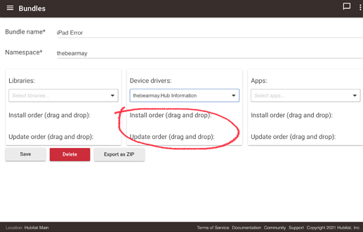

There is an issue with iPad/iPhone when trying to create or modify a bundle in that the drop down to select an ADL doesn’t populate the sort order so the change never gets saved.
