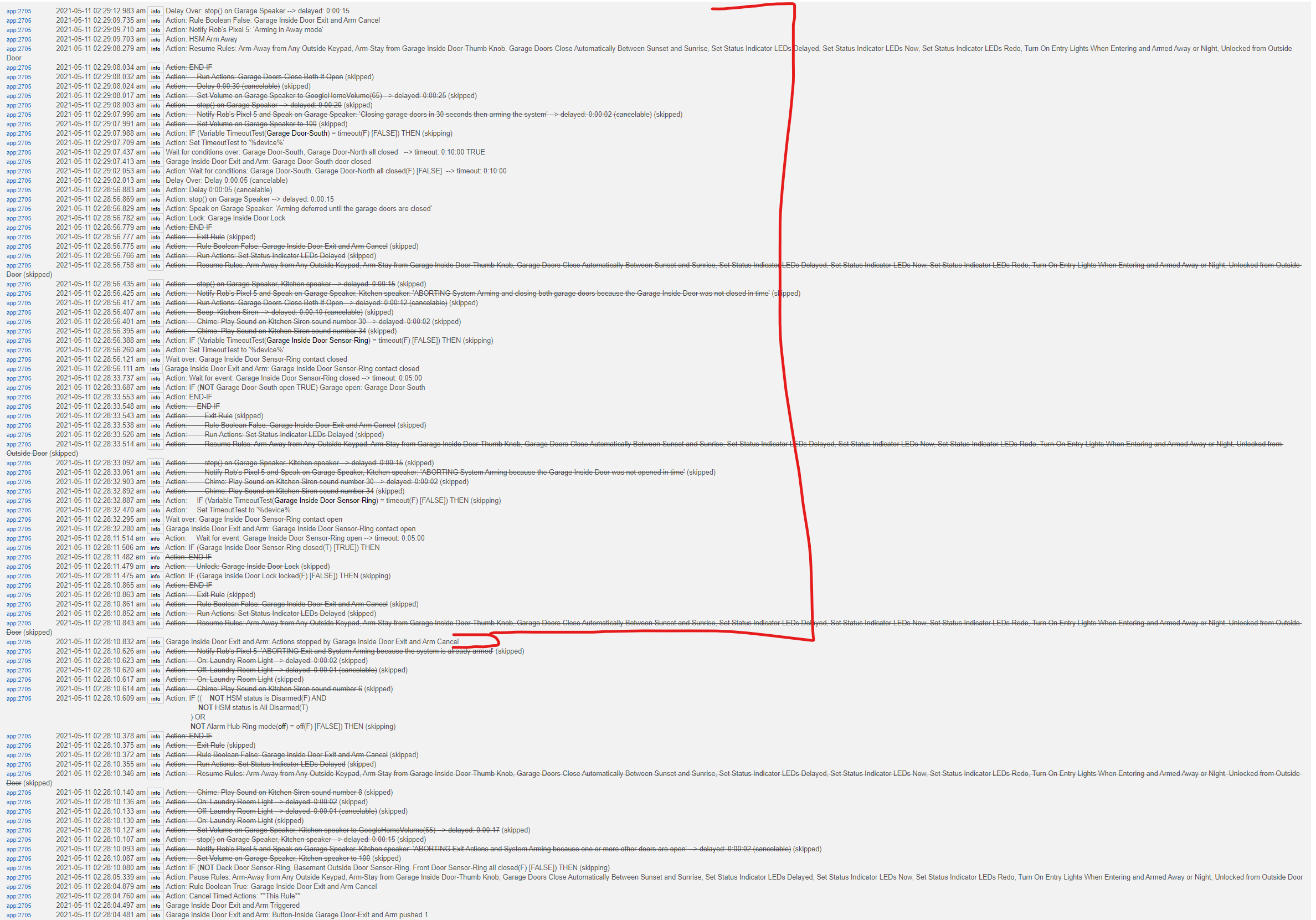

Here's a log where you can see that the "Garage Inside Door Exit and Arm Cancel" RM App issued a cancel against the executing "Garage Inside Door Exit and Arm" RM App.
However, the RM App I thought I was cancelling actually continued waiting on the "wait" and then, when that wait was satisfied, it executed all the remaining instructions. It clearly didn't get cancelled. Am I doing/expecting the wrong behavior? How can I cause an RM app to be cancelled during execution from another RM app?
