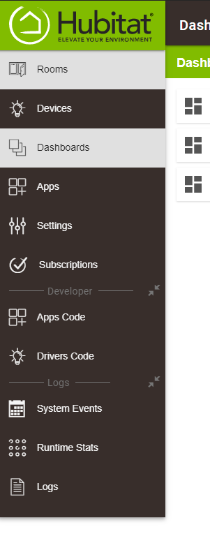

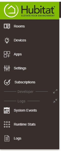

For me, I don't even have the Dashboard link any longer on the web UI. Seems to be fine on Android
Did it get moved, am I missing something?
Yes, we removed it from that left side menu. You can still access Dashboards from the Apps list, or from the mobile app.
I am still showing it
Did you upgrade to 2.2.7. If so, browser cache...
Thanks Bruce for the reminder that a link is available in the Apps > Dashboard section
I wouldn't have voted to remove it from the main list but hey, at least it's still there in the UI

Yes, I am on 2.2.7.119 and I just tried on a device that has never accessed the hub and it is still there. I am still on a C4 hub, if that makes a difference.
Seems kind of inconvenient to reach the dashboards now needs a lot more clicks. Much prefer it being left in the list to be honest.

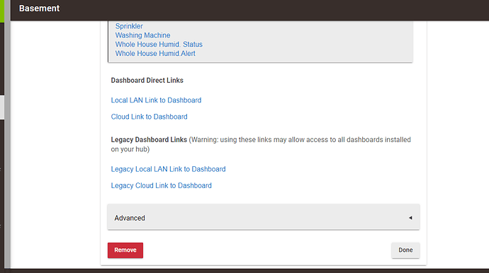

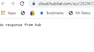

yes it is broken all my cloud dashboard links no longer work.. this is no good. i am using chrome.. i just get this "no response from hub"
adding a mised content exception does not work in chrome.. the cloud dashbaords are broken and this needs to be fixed.. reverting firmwares
also clearing browser cache does not fix the issue in chrome..
does not work in edge either and cloud dashboards also do not work direct from the dashboard page..
in the attached image clicking on either cloud link results in the same error both legacy and new cloud links are not working

you are right. i updated my other hub.. worked fine and cloud dashboards work fine..
so i redid the hub that was acting up with no cloud dashboards after the update.. it worked fine and now works.. only thing i can think is after restoring the older firmware i also restored a backup just to be safe..
really weird that now it works fine
I sure the reason why the dashboard link on the main UI page was removed was due to real-estate and with the addition of rooms.... something had to give
Just my $0.02
With the addition of collapse/expand of sections like dev code, logs... there is room now for dashboards
I don't use a tablet at all, seldom us the app on my phone, I am on the computer all day so the UI Dashboards are used a lot more.
Is there any way to make the main UI panel user configurable as to what shows/is hidden? Such as, I don't use rooms and at this time, see no need for it but sure miss the dashboards
Heck, I'd even suggest removing settings from the main UI page in favor of having dashboards. At least settings is 1 click away by navigating to the entry screen via the HE logo at the top of the main panel
Pretty please, add the dashboard link back
Rick
I second this proposal, I have no use for the new "rooms" however use dashboards everyday and would prefer dashboards to stay on the main UI.

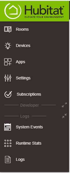

Do you have dashboards app installed but menu item on the left is missing?
Yes, dashboard is installed, 6 different dashboards. The removal of the Dashboard link in the Main UI is what's missing. Navigating into apps > Dashboard > Select dashboard > Select the local link is just not convenient
It's a bug which apparently doesn't manifest very often. Hotfix is coming.
