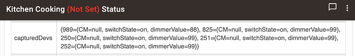

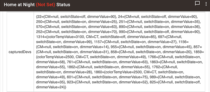

The screenshots below are taken from the state pages of two scenes (one large, one small) that exhibit this failure. One scene (the small one) is pure ZWave devices only. Some are S2, some older/no security — I mention this because it is consistently the S2 devices (paired as non-authenticated) that show the worst symptoms of the issue and the older style ZWave devices consistently work correctly. All of the devices in the simpler scene were part of the restore from backup and then manual reconnect of ZWave devices to the new C-7 per your instructions elsewhere on this forum.

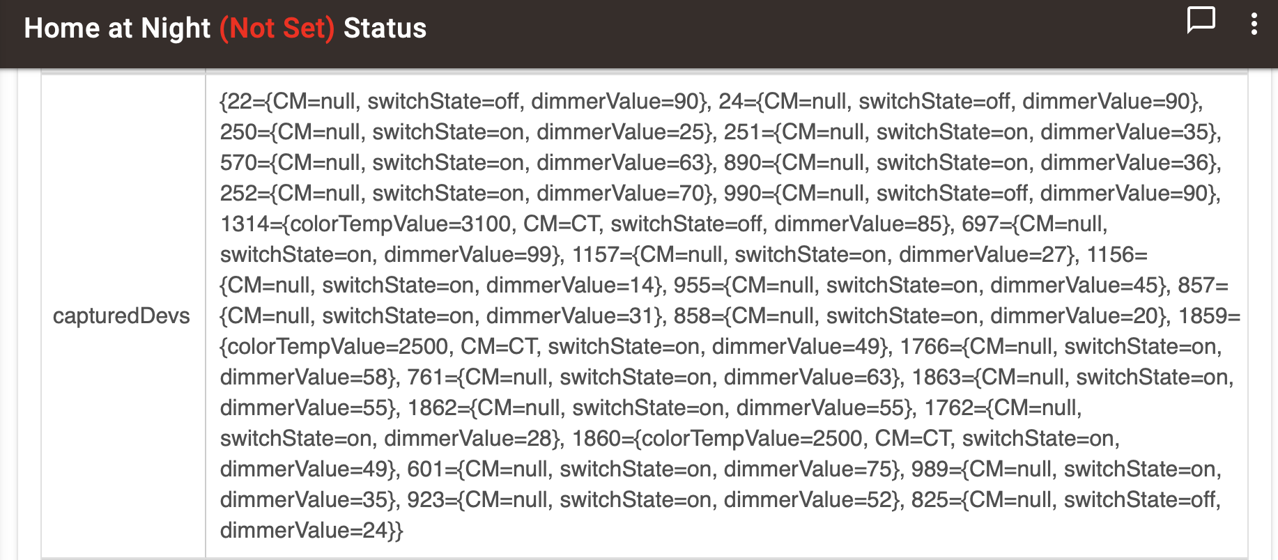

The larger scene has devices of different types including ZWave (mostly and about 50% S2 non-auth and the rest old style ZWave), WiFi (local, no cloud devices here), and ZigBee. Strangely this scene fails in all sorts of ways but it's only one or two devices at a time. Those sometimes are ZWave, sometimes WiFi, and rarely ZigBee but there are only two of those so the odds are in its favor. The other strange thing about this scene is on repeated attempts, I have seen some lights dim to values from ancient versions of this scene. For example there used to be a WiFi desk lamp in this scene at some non-zero value. Then I removed it completely from the scene. When I run the scene, sometimes that WiFi lamp will do nothing as expected. Sometimes it will turn off (strange). Sometimes it will go up to that non-zero value from some version of the scene that's over a year old. Yes this is erratic behavior and I wish I had more to give you to help troubleshoot it. I do have "ignore activate switch off" checked for all of my scenes.
