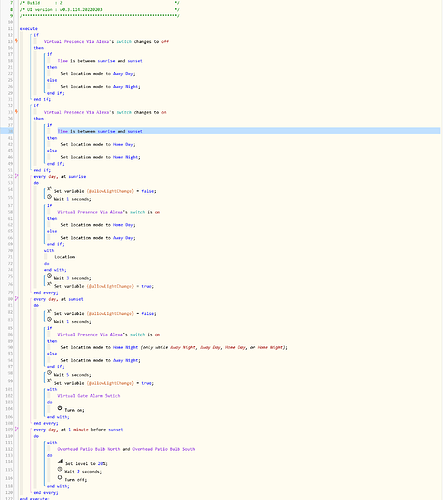

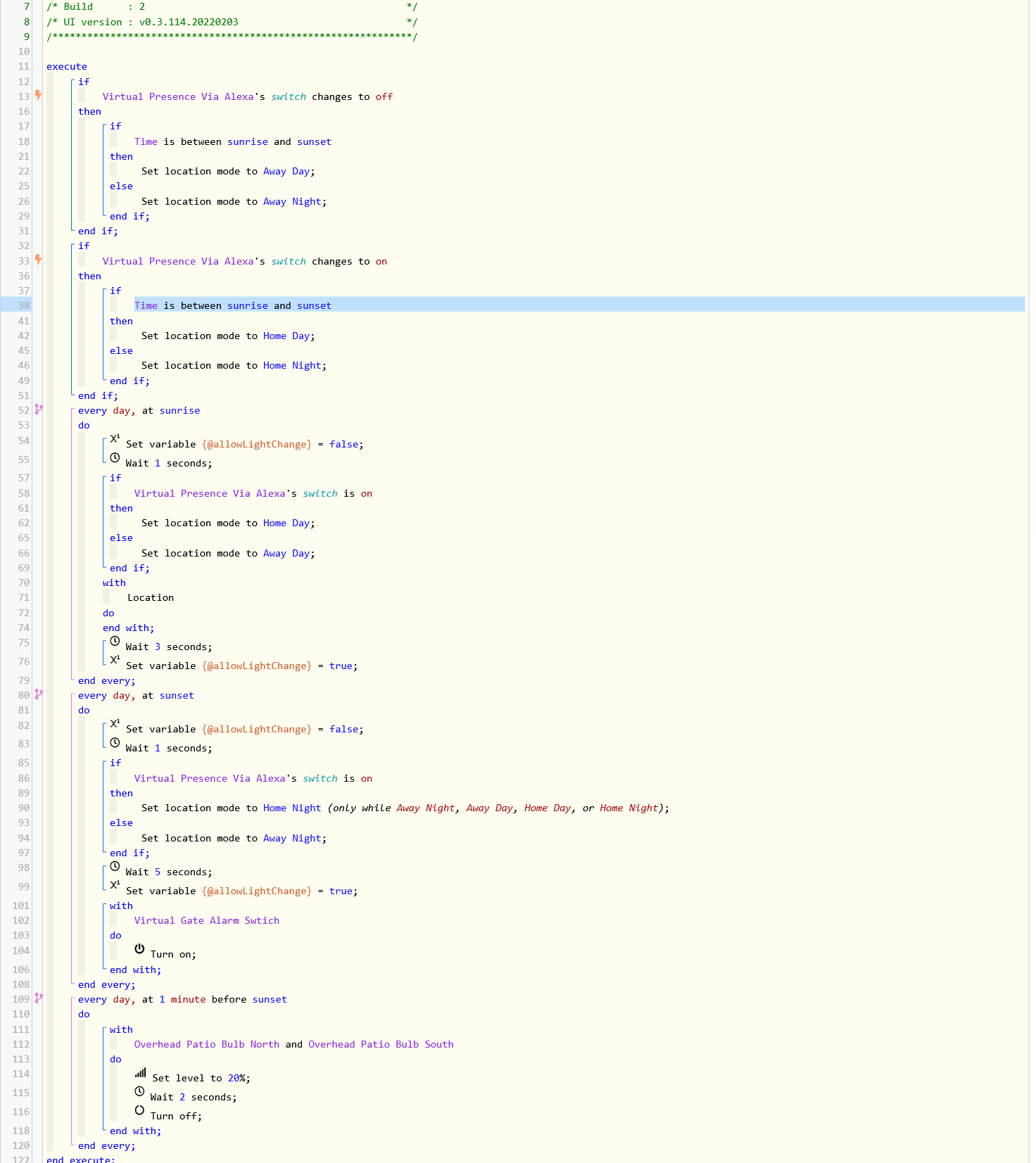

I’m pleased to report that after a week of using Alexa for geofencing, I’ve had a 100% success rate in determining location and managing location modes. If anyone is interested (and uses the Amazon ecosystem) here’s what I did:
Created a virtual switch in Hubitat called Virtual Presence via Alexa
Created 2 routines in the Alexa iOS app:
  1. New Routine -> When this device leaves -> Turn off Virtual Presence via Alexa
  2. New Routine -> When this device arrives -> Turn on Virtual Presence via Alexa
Created a piston in Webcore to manage location mode:
It's nice to finally have working presence and not have to deal with changing it manually or setting off the alarm. I also use presence to manage lighting, HVAC, and our security cameras so unreliable presence was a huge PITA.

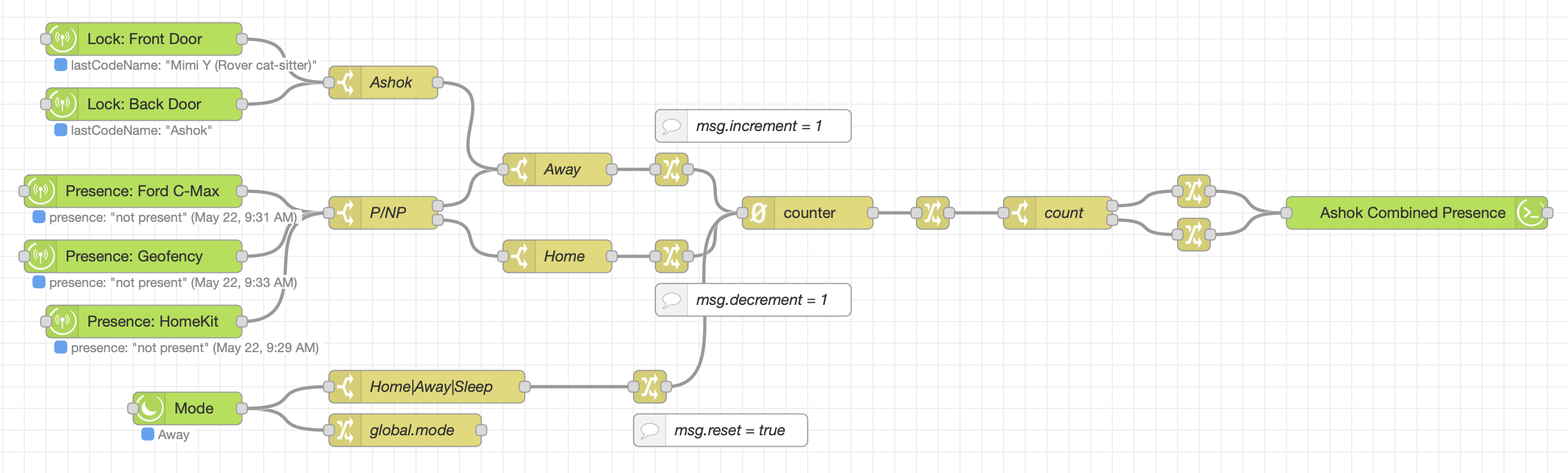

Presence is one of the few things where my entire logic is done in a Node-RED sequence. This is the sequence that I use to establish my "combined" presence:
  • I have 3 presence sensor that indicate "present" / "not present".
  • If they indicate "present" when the Mode is "Away", then a counter increments by 1. When the count is >= 2, my combined presence changes to "present".
  • Using my code on the front or back door lock is also counted as a "present" event. These events increment the counter by 2. So using a lock code is sufficient to change my combined presence to "present".
  • Similarly, when my presence sensors indicate "not present", and the Mode is "Home", the counter decrements by 1. When the counter is <= -2, my combined presence switches to "not present".
  • Finally, whenever there's a change in mode, the counter resets to 0.
This has worked flawlessly for years.
If I had any discernable Groovy skills, I would make this into a Hubitat app.
Alexa sees the virtual switch as a device and turns it on or off via an Alexa routine that runs when I enter or leave the geofence.
Webcore then manages location modes based on the switch's state changing to on or off.

@aaiyar : That would be the 'majority' state wins method, and I am guessing that is the most frequent logic when multiple sensors are being used. I wonder what you would do if you had an even number of sensors, with a 50% decision?
@markles: If you are only using one sensor (Alexa), this question is for those using multiple location based geo-sensors and their logic for handling different states of those sensors.
Logic would stay exactly the same. Since it is driven by the number of sensors that CHANGE status. Not the number whose status remains unchanged. Recall that in my setup, presence changes Mode. And a mode change resets the counter to zero.
