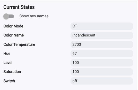

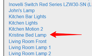

Both paired fine with Hubitat. I'm trying to get Kristines Lamp into Google Home. It's listed and I check on the device. (See screenshot below) Update and Save it and when I go back Google took it out so Google home is not fining it.
What is the issue here. I've check both Johns Lamp and Kristines Bed Lamp to make sure the Network IDs were different (they are) and setup the same way (they are)
Check to make sure that all of the states are populated. If not, you can run a command from the device page to get those initialized.

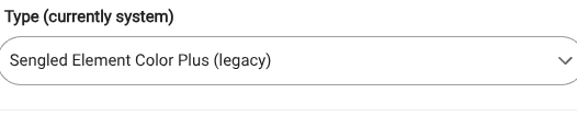

Also, make sure the driver on the problem device is the same as on the device that does get uploaded. (I used the legacy version because mine is hooked up to a dumb switch)
Thanks for the tip I actually changed it to the legacy and now it's working
