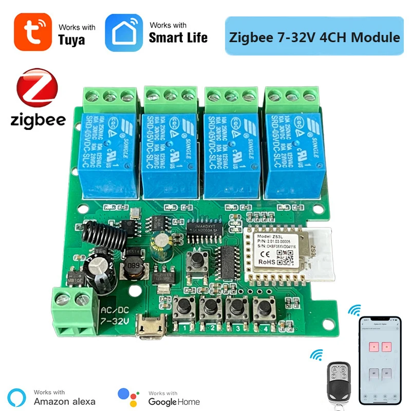

Personally, I’d replace them with momentary zigbee relays, which are inexpensive and guaranteed to work reliably with Hubitat. Look up MHCOZY zigbee relays on Amazon.
I believe this is exactly what your looking for. Even has a case on thingiverse you can print for it if you need. They also have a 2 and 4 channel.
MHCOZY 1 Channel 5V 12V ZigBee Smart Relay Switch,Adjustable Selflock and Momentary Working Mode,Works with Philips Hue, SmartThings, Alexa, Google Home (ZigBee Hub Required)) Amazon.com
I'm speculating because I only have the single versions but this is the name of the driver it uses in Hubitat. Makes me think it's the same for all of them.
I have the switches now when i add them i only see one switch out of the 4. One thing i have noticed is once if i select a device and save and go to the home page for devices does not save.
I have one of these and each channel is independently controllable.
Assign the “generic zigbee multi-endpoint switch” driver on the device settings page, save, and then click configure. It should create four child devices.
