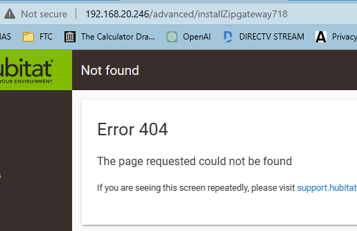

It looks like it does something quick then a 404 message comes up is that normal?
Ahh.. no 404 means it's the wrong url... and I see I had a typo there.. I apologize, I haven't had coffee yet..
/hub/advanced/installZipgateway718
Still 404, coffee needed
Ok.. Odd .. This is the correct endpoint.. are you sure you got the uppercase Z in there, it is case sensitive .. If it still doesn't work can you screenshot the url you are using in your browser?
Ok.. I see the problem .. you missed the /hub/ part
http://<your-hub-ip>/hub/advanced/installZipgateway718
Rebooting. Yep the green /hub I assumed was the hub's address.
Not sure why discourse was coloring it green .. but I can see why that was causing confusion..

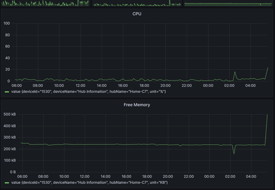

@bcopeland This morning again the Z-Wave radio was not operating on my primary C7 hub. That is after we put in the the new Z-Wave gateway. I don't know what time it crashed but I assume it was around the nightly backup since the backup also failed and the backup's to the cloud include Z-Wave devices.
I am shutting down and doing the power cycle at 5:20 AM central right now that should bring it back. This is now the 4th time since December I am wondering if I should do a swap between my development Hub and this Hub with a full backup and restore to restore the Z-Wave on the Dev hub. But that would also mean having to re-include the ZigBee devices on the Dev Hub. This may point to a Z-Wave radio that is starting to go bad in the current production hub. Thoughts?
Here is the CPU and Memory chart of over night and you can see right around 2:30 a spike in CPU and a drop in free memory. I don't know if that is the DB cleanup or somehting else but backup's are scheduled for 2:15.
